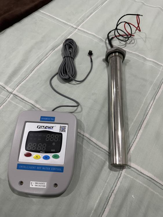

May 3, 20233 yr Author Just got my new thermostat and Geyserwise timer and geyser blanket, waiting to fit it…..😁

May 3, 20233 yr Huh????? You have an awfully large thermostat. 😅 It would do nicely as a self-defence weapon. That clobbering tool is not a thermostat but a PTC element. The new thermostat is a very small device with thin wires that gets inserted into the hollow tube in which the old thermostat was mounted. If you want to fit that PTC element you would need to drain your geyser (at least partially).
May 3, 20233 yr 7 minutes ago, Modina said: If you want to fit that PTC element you would need to drain your geyser (at least partially) While draining the geyser, you might as well turn it on its head and mount it outside if you haven't yet. Outside will save you some cupboards when the geyser bursts. And I am confident that you increase the hot water capacity when the geyser is standing upright vs on its side.
May 3, 20233 yr Author Lol…this is the 2kw Geyserwise element and not thermostat Geyserwise PTC Stainless Steel 230V Electrical Geyser Element 2kw source https://www.livestainable.co.za/product/geyserwise-ptc-stainless-steel-230v-electrical-element-2kw/?gclid=EAIaIQobChMIl8apwuTZ_gIVEMbtCh1uVwX4EAQYASABEgLsp_D_BwE

May 3, 20233 yr Author So my Geyserwise timer comes with WIFI do I still need the control box, what’s it’s purpose?
May 3, 20233 yr The control box has a power supply to power up your keypad. It also reads the new thermostat and houses a relay to switch the element on or off.
