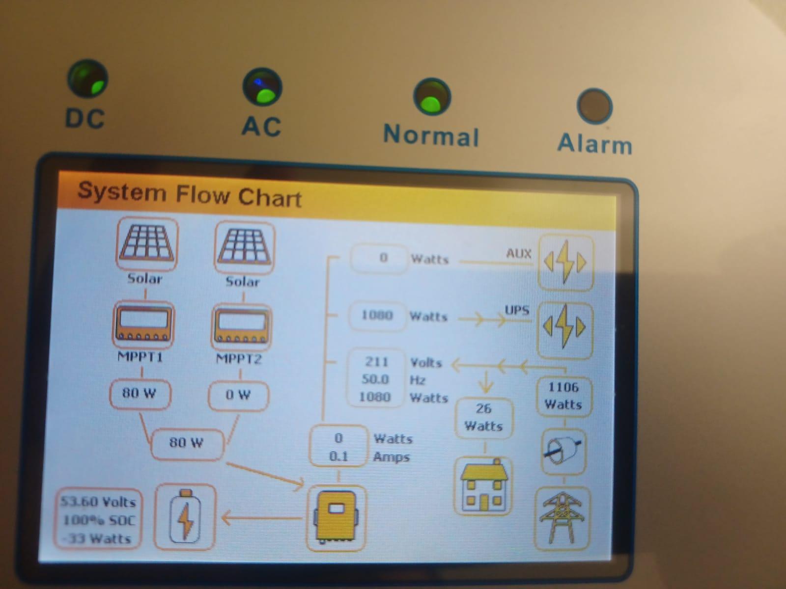

31 minutes ago, GreenFields said:
What is it doing right now? Show the System Flow Chart again.
According to your settings if you start with a 100% full battery, I suspect it should now be drawing power from the battery until you get to 90%. Turn on a heater or something to make it go faster to see if it works. Suspecting that since you had Grid Charge ticked, the inverter was keeping the battery at 100%
Is battery output supposed to be higher ?
Edited by Red Falcon
Wrong pic
44 minutes ago, Red Falcon said:
What am I missing ?
Are all my settings I posted above , correct ?
On the system mode - > mode2 untick 'soler export'  then to test tick 'Limit to load only' the inverter should then send battery power to your essentials only. Did it work?
Nope. Still the same 🙃
