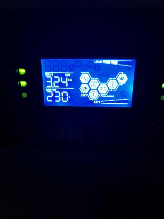

So I finally had panels installed- to recap my system:
1x 6kw Axpert King
1x 5kw Narada Lithium
7x JA Solar panels
Attached is what I’ve noted anecdotally-
Now I don’t know if this is good, bad or average.
Any thoughts?

Not sure what size panels you fitted but if they are around 550W you should get max 3.85kW. Getting 3.2kW this time of the year is fairly good.
I also went for the larger wattage panels - they take up less roof space.
