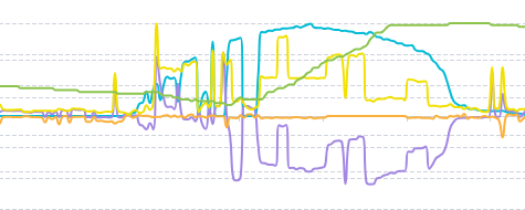

Saturday morning we had an early morning outage (not load shedding). Round about 9AM. It was a clear, sunny day, but look...
If you're not familiar with SEMS portal, the blue line is PV being drawn from the panels, green line is SOC, orange line is load.
PV drops just as the outage begins. You can't see the blue line because it is on the zero axis, behind other lines.
