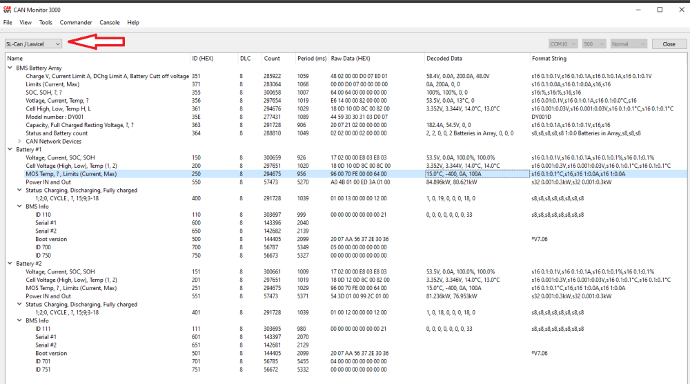

For reading the CAN Bus, this adapter is fantastic: https://www.robotics.org.za/MKS-CAN-V2-STD
Then use https://github.com/tixiv/CAN-Monitor-qt exec in the releases segment
Open CAN Monitor 3000, select SL-Can / Lawicel and open the COM port for the device at 500kBit/s
If the wiring is correct the device LEDs should start flickering and the serial frames will get dumped in application
batteries in arrays(2+) have ID's offset by one normally.
the for the format string just try s16,s16,s16,s16 that should decode standard CAN Frames
Then you can at least see the raw data.
Then organize and label the info like this
Hope this helps
EDIT : I should add you can do this whilst it is talking to your inverter, effectively listening.
Regards

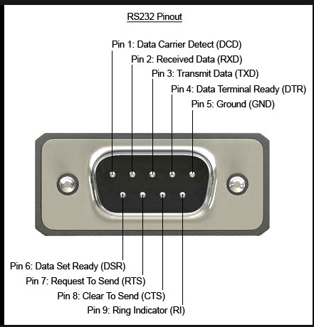

1. Rig up a USB to RS232 adaptor to connect to the RJ12 port as per the connection information below:
Battery RS232 Port
My USB to RS232 Adaptor pinout
In my case the I had a USB to RS232 adaptor with a D-SUB9 connector as seen above.
The connections I made were as follow:
Please don't just look at pin numbers as the function is more important than the pin number ie. RX, TX and GND. So if your RS232 Adaptor is different to mine rather use the functions to guide your connections.

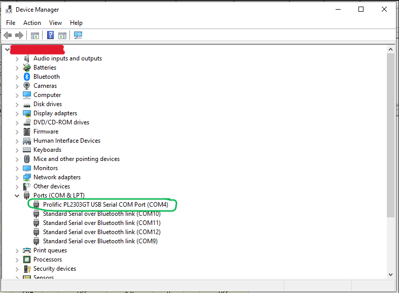

2. Make sure the driver is installed for your USB to RS232 Adaptor on the PC you plan to use. Check Device Manager to determine if it is installed and also look at which COM Port number is assigned to the USB to RS232 adaptor (see example circled in green -mine is COM4).

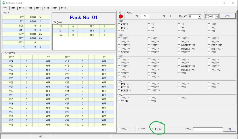

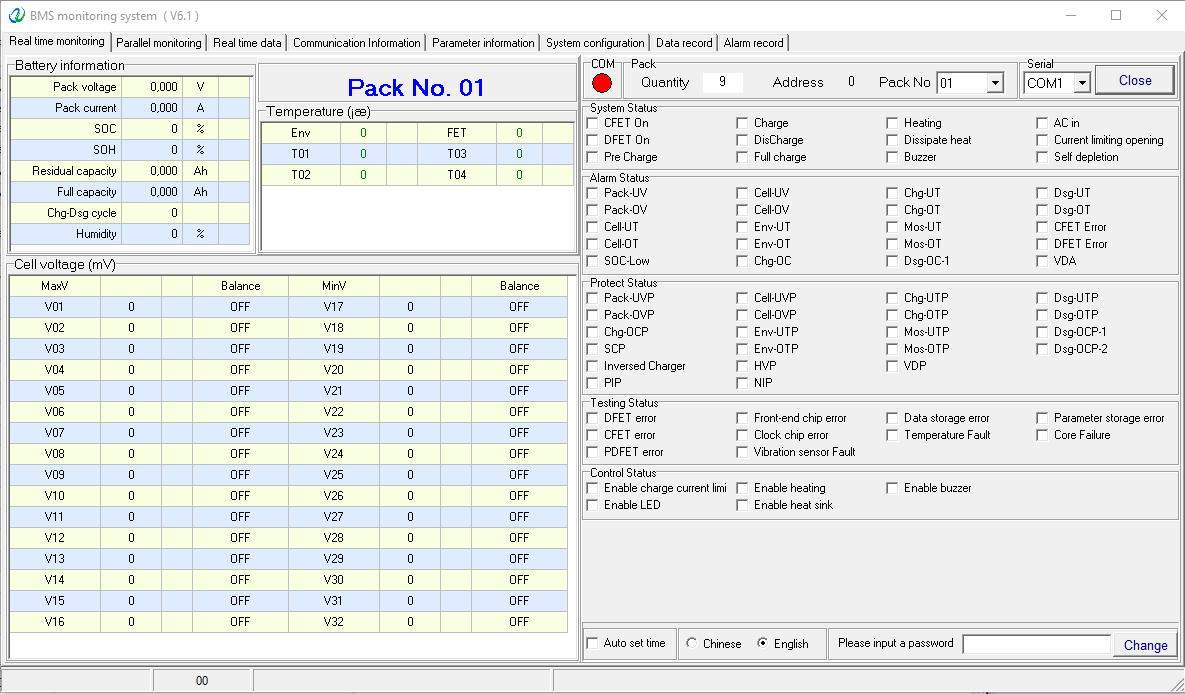

If it is your first time opening it, it will most likely look like this with ????????????????? everywhere. Just select English at the bottom of the screen (circled in Green)image.thumb.png.337c11396b7f1cc09f25ac4ae0ed822a.png
It now should look like this:
6. Click on the "Close" button located next to the Serial COM window in the top right. Wait for the button to say "Open". now select your COM port Number in the drop down box to the left of the "Open" button (it is the one from Step 2 above - yours will be different). Once selected, click "Open". You will most likely see a message appear at the bottom below the "English" language selection that says "--6 Invalid Data".

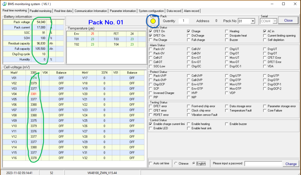

7. Input the password in the password box on the bottom right. DON'T press change. Simply hit the ENTER key on your keyboard. The Password as per the VOLTA Manual is "green1234".
8.If all went according to plan, the screen should show the battery information circled in green below. The COM light (Blue circle) should also flash GREEN/YELLOW indicating that the communication with the BMS is active.
Lastly for those interested the RS232 Baud Rate is 9600bps by default.
