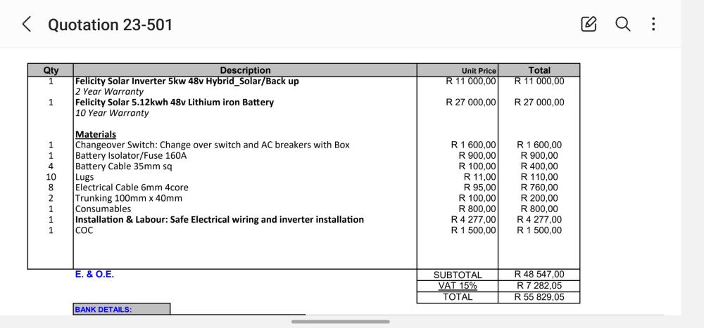

August 24, 20232 yr Hi All, I received a quote to for a backup battery system as I am not yet ready to go full solar. The quote reads as follows: Felicity Solar 5kw 48v Hybrid inverter Felicity Solar 5.12kwh 48v Lithium Iron Battery All the other installation stuff Final Cost R55 829.05 (incl VAT) This is within my budget and I'm keen to escape the clutches of load shedding. My only concern is the Felicity Solar part, I haven't heard much of them however they look like a decent outfit, the quote came from the company Caprica Solar here in JHB and they seem like a legit outfit. They have a proper website with some reviews and they have a store that I will visit tomorrow after work. Has anyone had any experience with Felicity Solar and Caprica?

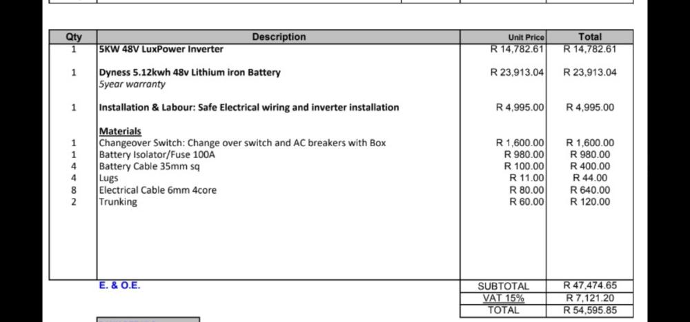

August 27, 20232 yr Author On 2023/08/25 at 6:47 AM, Chris Louw said: What does all that stuff include.Get a proper quote. Apologies I realise that my post was not detailed. I have attached the 2 quotes received. One has a Luxpower Hybrid Inverter and the Other has the Felicity solar option. I was informed that when the Luxpower operate in back up. Mode with no solar feed, they cap at at 3.8kW, is this true?
August 27, 20232 yr 18 minutes ago, Tuntira972 said: I was informed that when the Luxpower operate in back up. Mode with no solar feed, they cap at at 3.8kW, is this true? That may be due to a max 80A battery discharge current which equates to around 4kW, meaning if you run purely on Battery than there is a limit.
August 27, 20232 yr Author 2 hours ago, zsde said: That may be due to a max 80A battery discharge current which equates to around 4kW, meaning if you run purely on Battery than there is a limit. I see... Apparently the felicity slay inverter does not have such a limitation. However it's app is not as good as the Luxpower option. I'm leaning towards the Luxpower because it's a bit more popular and we'll known. Not sure what your thoughts are on that
August 27, 20232 yr The battery is what is limiting your output. You can only use the rcommended discharge rate of the battery.If you want the full output of the inverter, more batteries must be installed. 5.12kWh is not enough for 5kW output on batteries only. Luxpower is the better option. Edited August 27, 20232 yr by Chris Louw
August 27, 20232 yr Author 13 minutes ago, Chris Louw said: The battery is what is limiting your output. You can only use the max discharge rate of the battery.If you want the full output of the inverter, more batteries must be installed. 5.12kWh is not enough for 5kW output on batteries only. Luxpower is the better option. I see, what size battery would I have to get to get the max output of 5kw?
August 27, 20232 yr The battery must have recommended discharge rate of 104 Amp for 5kW output. Recommended discharge rate depends on the brand of battery. Best to get the specs from the supplier.
August 27, 20232 yr Author 4 minutes ago, Chris Louw said: The battery must have recommended discharge rate of 104 Amp for 5kW output. Recommended discharge rate depends on the brand of battery. Best to get the specs from the supplier. I took a look at the felicity solar, that battery/inverter combo provides power at 100A, this is most likely where the full 5kw is from, where as the Dyness on the first quote is 75A, which is where the 3.75kW is coming from. Maybe a question I should be asking is, do I need to be supplying power at 5kW vs 3.75kW while on battery?

August 27, 20232 yr Author 39 minutes ago, Scorp007 said: Also at Computech 5kW SNA 55 minutes ago, TaliaB said: Enway Power Solutions Midrand SNA 5000 Hybrit inverter+Dongle+free delivery https://www.enway.co.za/luxpower-5kw Great! Thanks guys! I have also been doing further research on the SNA, apparently it is the weaker of the 2 between it and the LXP. My Use case will be as follow: 1. Auto switch over during LS to keep essential items alive (TV, PC, Light and Fridge). 2. I don't need the geyser or stove to be backed up. 3. I would like the option to add solar in the future. 4. I am not interested in feeding back to the grid as I don't foresee that worthy of investing in due to the goverment and its nonsense It seems like the SNA is enough for me, however I am wondering if the LXP will be better

August 29, 20232 yr You can get a Luxpower SNA with a 5.12kw Dyness/Volta/Shoto/Hina Ess and all accessories required for the install at around R39k-R40k. Then add cost of labour/coc. Mirua technology has a Luxpower SNA 5kw + battery backup system incl installation at R42,450. Not bashing any other supplier/installer nor am I trying to advertise them, just giving a heads up that pricing has come down significantly and you can get a 5kw backup system installed with good components for cheaper than R54k.

August 29, 20232 yr 4 hours ago, YellowTapemeasure said: Without a doubt, and especially because the OP wants to get solar power in future, I would opt for the Solis S6 5K and a 5.1kWh Magneto battery from Powerforumstore, comes to 44K. It's way advanced in terms of features, functionality and capacity, so far more expandable. Alternatively, swop the 5.1kWh Magneto for the 9.6kWh Magneto, it's a steal at R39,965. Good price on that Magneto 9.6kWh battery. Svolt batteries also seem to have really good pricing, I have seen their 106AH batteries retail for under R20k. @Tuntira972 I would personally go for a Luxpower SNA5000 (The inverter I am currently running) or the Solis S6 inverter if budget allows. However for your needs, it sound as if the Luxpower is sufficient so it might make more sense to save the money and add it to your "solar panel fund". The Dyness batteries are not 1C and therefore you would not get the full 5KW out of the Dyness battery regardless of which inverter you use - you would need to have 2x Dyness batteries to get 5KW+ So if you want to go with the Luxpower then a different battery would be recommended.
