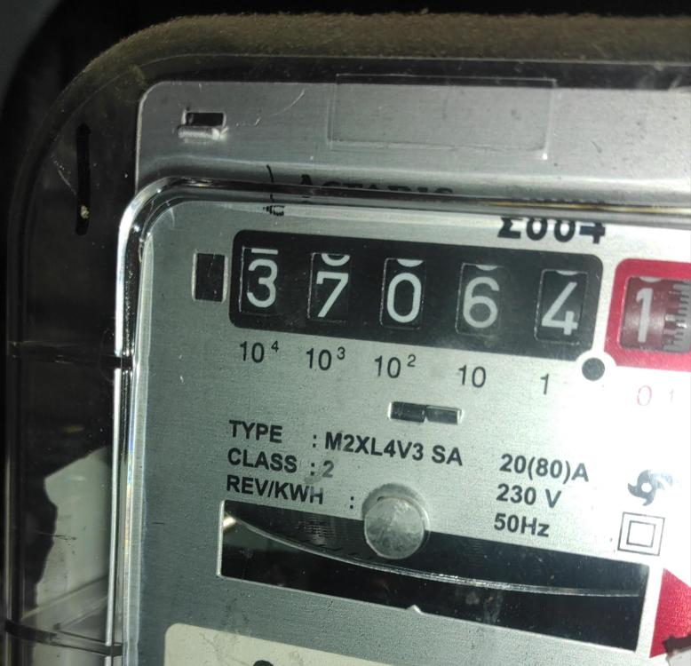

Does anyone know which meters run backwards if power is fed back into the grid?
Attached is the meter I have
Good Morning my dear Power Friends
That little ratchet symbol on the right below the last digit tells you it won't run backwards.

Yeah, there's approximately 0% chance that they will replace it with one that will reverse.

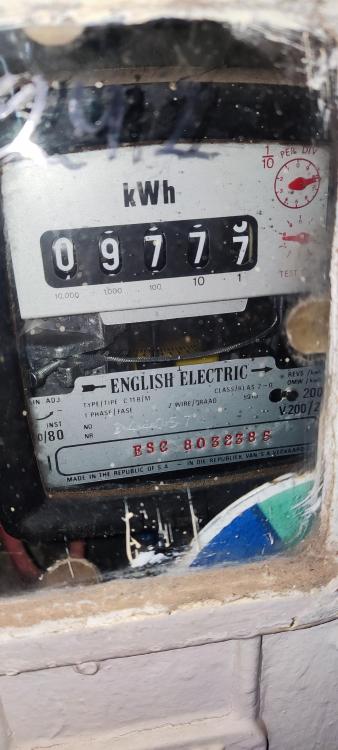

Does mine spin I'm reverse? It looks older than me

This meter belonged to the stone age. EE was merged with GEC in 1968 according to Google. So this meter was made before that year. Amazing it is still turning. Based on the age my guess it will turn backwards as meters made in 1990 can turn backwards. The ratchet system I guess was only introduced later.

Wow then it's much much older than me! Impressive. Made in SA before the Chinese came in and killed quality producing factories

ESC was the old abbreviation in English before the name change to Eskom.
Som of the older spinning disk meters will run backwards but only until the second to last digit reaches 0. Thereafter it sticks to 0 while the last digit keeps on running backwards.
