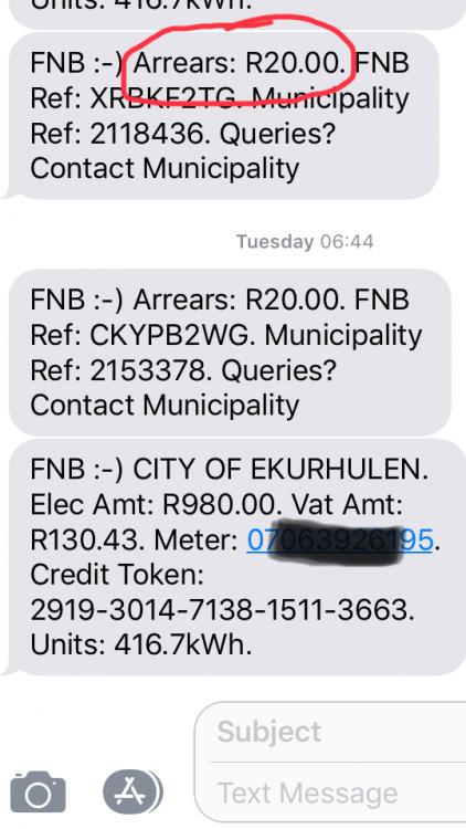

17 hours ago, Achmat said:
It's added at the point of purchase so not an FNB issue. It wouldn't matter where a bought the prepaid units from as its applied at the point of purchase.
In COJ, and I bet, in other municipalities, they do something similar with arrears.
Say I am in arrears on my municipal account - any portion of it, not just electricity - and I try to buy pre-paid electricity, they will first offset whatever amount I am spending against arrears. Obviously with a cut off. I my account is overdue by one day then they won't, but if I'm months in arrears then they will.
Similarly if I want to convert to pre-paid, I may not be in arrears on my account.
