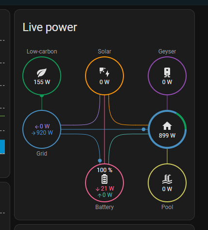

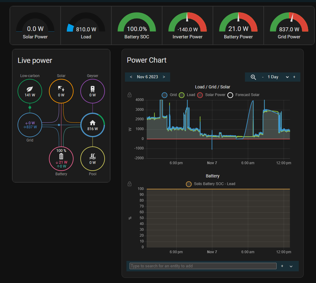

November 7, 20232 yr Author For a nice live power view like this Just install power-flow-card-plus from hacs, I also recommend apexcharts-card for charting. The integrated "energy" view from HA doesn't support live information, so it's better to build your own energy dashboard For a "Gettting Started Dashboard" Install the following from hacs first layout-card stack-in-card history-explorer-card power-flow-card-plus views: - theme: Backend-selected title: Solis path: solis icon: mdi:flash cards: - type: custom:layout-card layout_type: custom:vertical-layout layout: width: 1000 max_cols: 1 cards: - type: custom:stack-in-card title: null mode: horizontal cards: - type: gauge entity: sensor.solis_inverter_dc_power name: Solar Power max: 6000 min: 0 needle: false - type: gauge entity: sensor.solis_backup_load_power name: Load max: 6000 min: 0 needle: false - type: gauge entity: sensor.solis_battery_soc name: Battery SOC needle: false severity: green: 50 yellow: 20 red: 12 - type: gauge entity: sensor.solis_inverter_ac_power name: Inverter Power max: 6000 min: -6000 needle: true severity: green: -6000 yellow: -10 red: 10 - type: gauge entity: sensor.solis_battery_power name: Battery Power max: 6000 min: -6000 needle: true severity: green: -6000 yellow: -10 red: 10 - type: gauge entity: sensor.solis_grid_active_power_negative name: Grid Power max: 6000 min: -6000 needle: true severity: green: -6000 yellow: -10 red: 10 - type: custom:layout-card layout_type: custom:masonry-layout layout: column_widths: 1fr 2fr; width: 400 cards: - type: custom:stack-in-card title: null mode: vertical cards: - type: energy-solar-consumed-gauge - type: custom:power-flow-card-plus entities: battery: entity: consumption: sensor.solis_battery_discharge_power production: sensor.solis_battery_charge_power state_of_charge: sensor.solis_battery_soc invert_state: true state_of_charge_unit: '%' display_state: two_way use_metadata: false color_value: true state_of_charge_unit_white_space: false grid: entity: sensor.solis_grid_active_power invert_state: true use_metadata: true name: Grid power_outage: entity: switch.grid_status_11 state_alert: 'off' solar: entity: sensor.solis_inverter_dc_power display_zero_state: true home: entity: sensor.solis_backup_load_power clickable_entities: true display_zero_lines: mode: show transparency: 50 grey_color: - 189 - 189 - 189 use_new_flow_rate_model: true w_decimals: 0 kw_decimals: 1 min_flow_rate: 0.75 max_flow_rate: 12 max_expected_power: 6000 min_expected_power: 300 watt_threshold: 1000 transparency_zero_lines: 0 title: Live power view_layout: position: sidebar - type: custom:history-explorer-card header: Power Chart cardName: historycard-93716784 combineSameUnits: true graphs: - type: line title: Load / Grid / Solar options: interval: daily ymax: 4000 entities: - entity: sensor.solis_grid_active_power_negative name: Grid - entity: sensor.solis_backup_load_power name: Load - entity: sensor.solis_inverter_dc_power name: Solar Power - entity: sensor.power_production_now color: white fill: rgba(0,0,0,0) name: Forecast Solar - type: line title: Battery options: interval: daily ymin: 0 ymax: 100 entities: - entity: sensor.solis_battery_soc Edited November 7, 20232 yr by Pho3niX90
