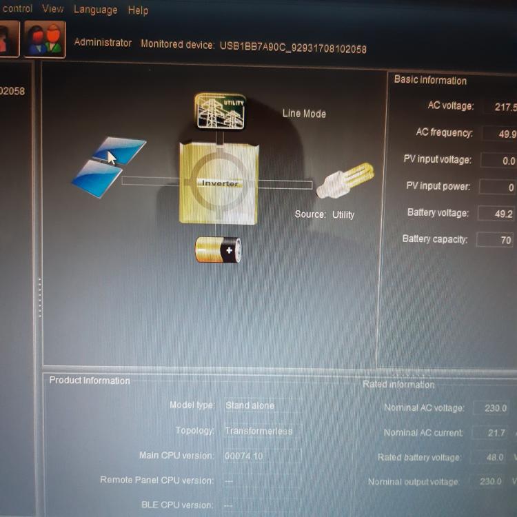

Hi, I'm new to the forum. I have a 5048MS PIP from 2017 (basic version of the processor 74.10), yesterday I received a 5048MS 64V (72.40). A parallel map also arrived. Will it be a problem that they have different firmware? Please help. Thanks in advance .
Link to comment
Share on other sites
Yes, it will be a problem; you can't mix 64 V and non-64 V firmware. [ Edit: in a parallel or 3-phase setup. Running separate loads on them is fine, as long as the 58.4 V model never sees battery voltages above about 60 V. ]

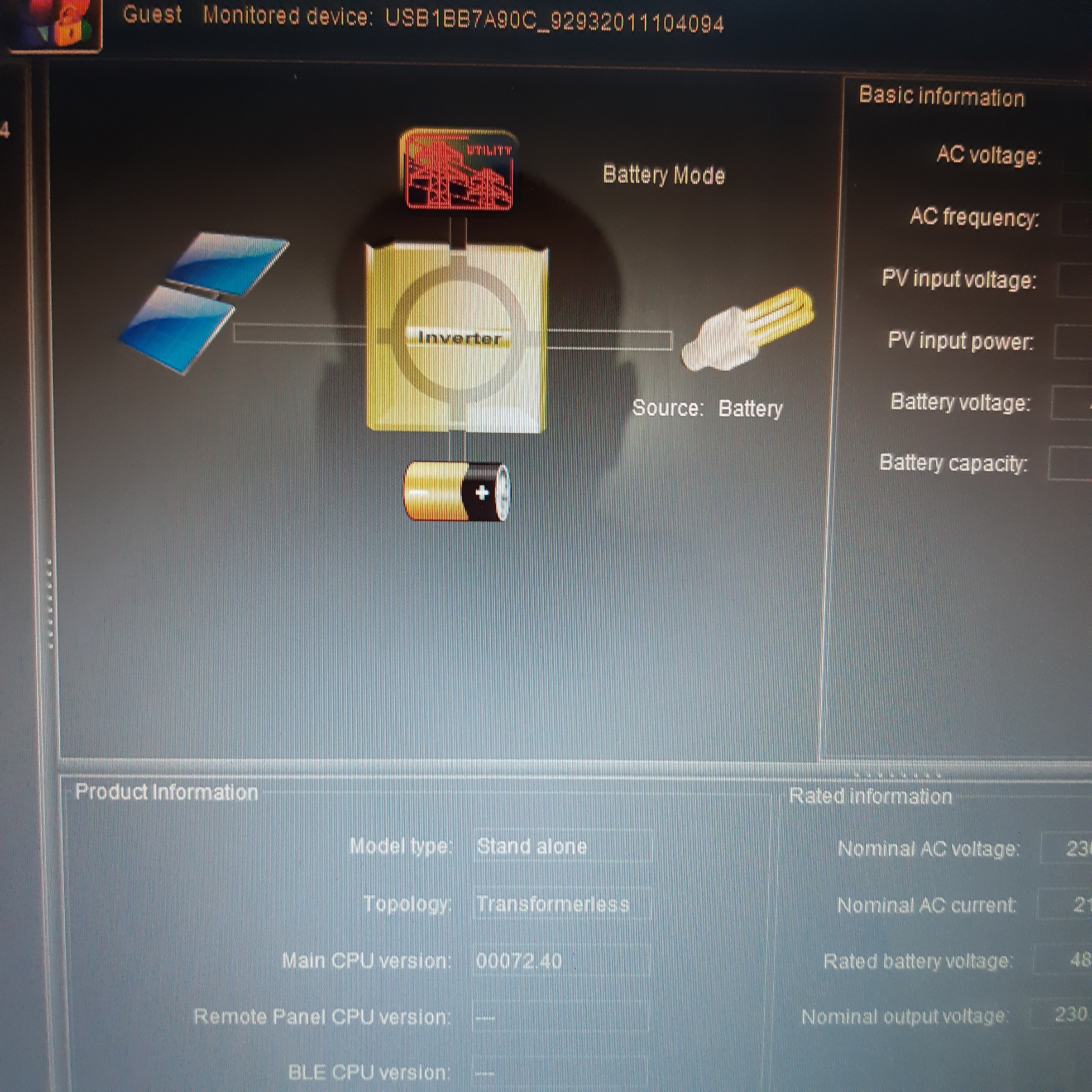

Hello again, after connecting the two inverters in parallel, my new one got error 71 (firmware). Is there any common firmware for 5048 MS (74.10) and 5048 MS 64V (72.40)? Will it not be possible to change the firmware of the 5048MS 64V to 74.10 or vice versa? Thanks in advance .
Link to comment
