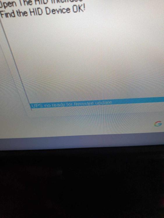

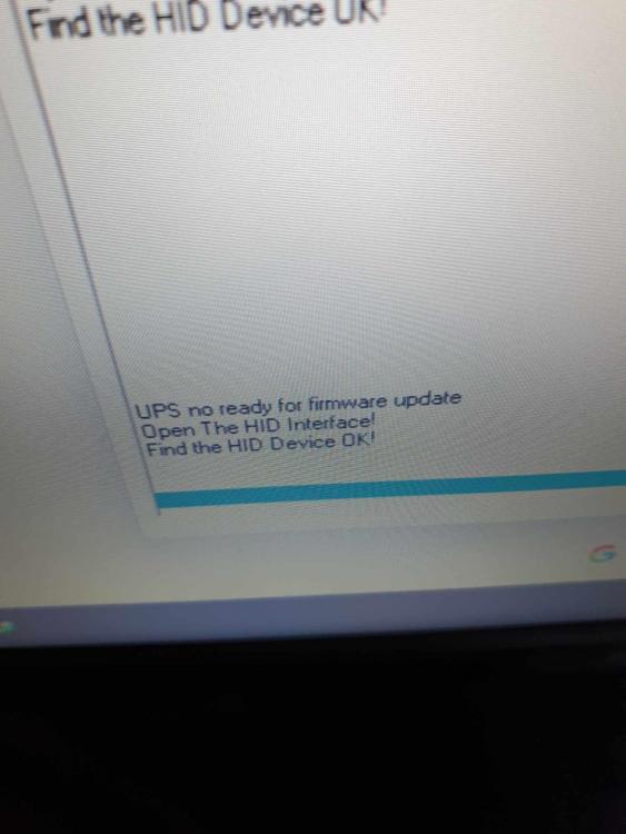

June 19, 20242 yr Please find the appropriate software for this device I tried 60.6 60.89 Software is not accepted

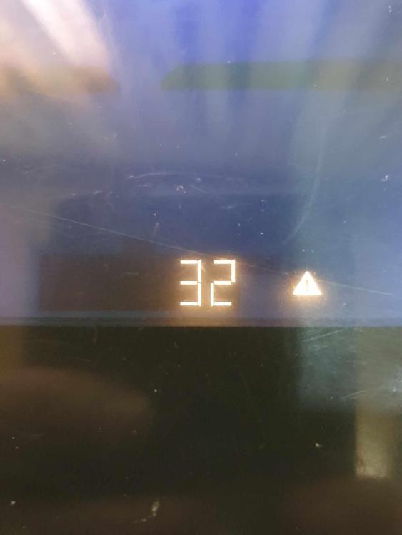

June 20, 20242 yr Is this a 5.6kW model, or 6.0kW, or perhaps 4.0kW? Is it definitely a Twin? Do you happen to know what version of main (U1) firmware it came with? Does the warning code 32 come up if you restart? If so, it's likely that a partial firmware was updated. If so, you should be able to restart the firmware update. Worst case is if there is incompatible or corrupt firmware in there. In that case, you have to time the pressing of the final button exactly the right tine after you power up. See my If You Think Your Inverter is Bricked page for clues.

June 20, 20242 yr Author vm iv twin 4k The old version was 60.06, which opens panels from 60 v I tried to update it to version 70, which is on the forum, and it started giving error 32. I tried to download all the versions on the forum when it reaches 5%. Sometimes it reaches 12% or 40%, then it gives me an error in sending data to the inverter. Is it possible to have a version that works on it without problems? When running, the screen components turn on, a counter goes from 8 to zero, then an error is 32. Please help.
June 20, 20242 yr Author I tried all versions on the forum and the same result. When it reaches 6%, 10%, 15, or 30%, it gives me a reading or sending error.
