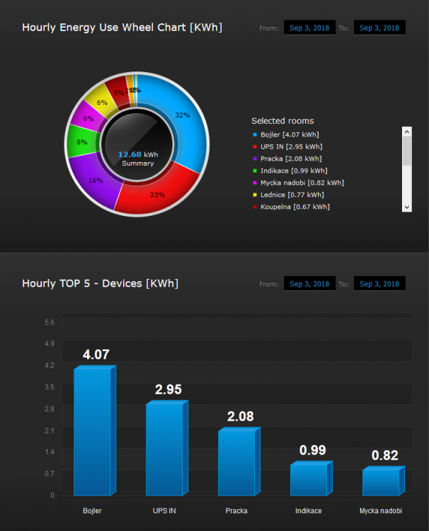

1) If you mean it serious and want to have a robust system for the whole house, then look at KNX with some central automation like Loxone.
KNX is available worldwide, but I'm not sure whether Loxone has a presence in the SA, or whether there's some other automation used widely.
2) Other option is Fibaro and zwave. Not so robust like KNX, but it's fun to play with. Check my thread as I'm using Fibaro for everything: https://powerforum.co.za/topic/2322-youdas-off-grid-lab/?do=findComment&comment=37703
