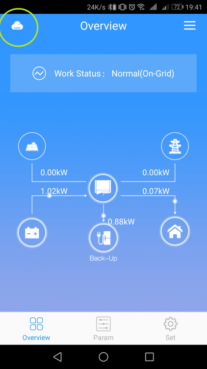

November 15, 20196 yr haha, so it is possible to connect to inverter through the local wifi network in PV Master! You just need to tap the "SEMS icon" in the left top corner and it will connect you to the inverter and you are able to do everything in PV Master 👍 next step -> find out how to connect it to Raspberry Pi and be able to control and set up inverter with some basic scripts, so I can make the whole PV system much more efective
