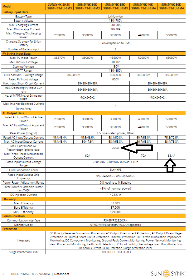

October 31, 20241 yr Check your Eskom feed MCB, and size it similar on the input. If you are hoping to use higher power in the day on your essential loads (Eskom + Solar + Battery), add Eskom MCB value to 83.4A, with a max of 200A. By the way, beautiful machine, I'm jealous.😂 Edited October 31, 20241 yr by TimCam

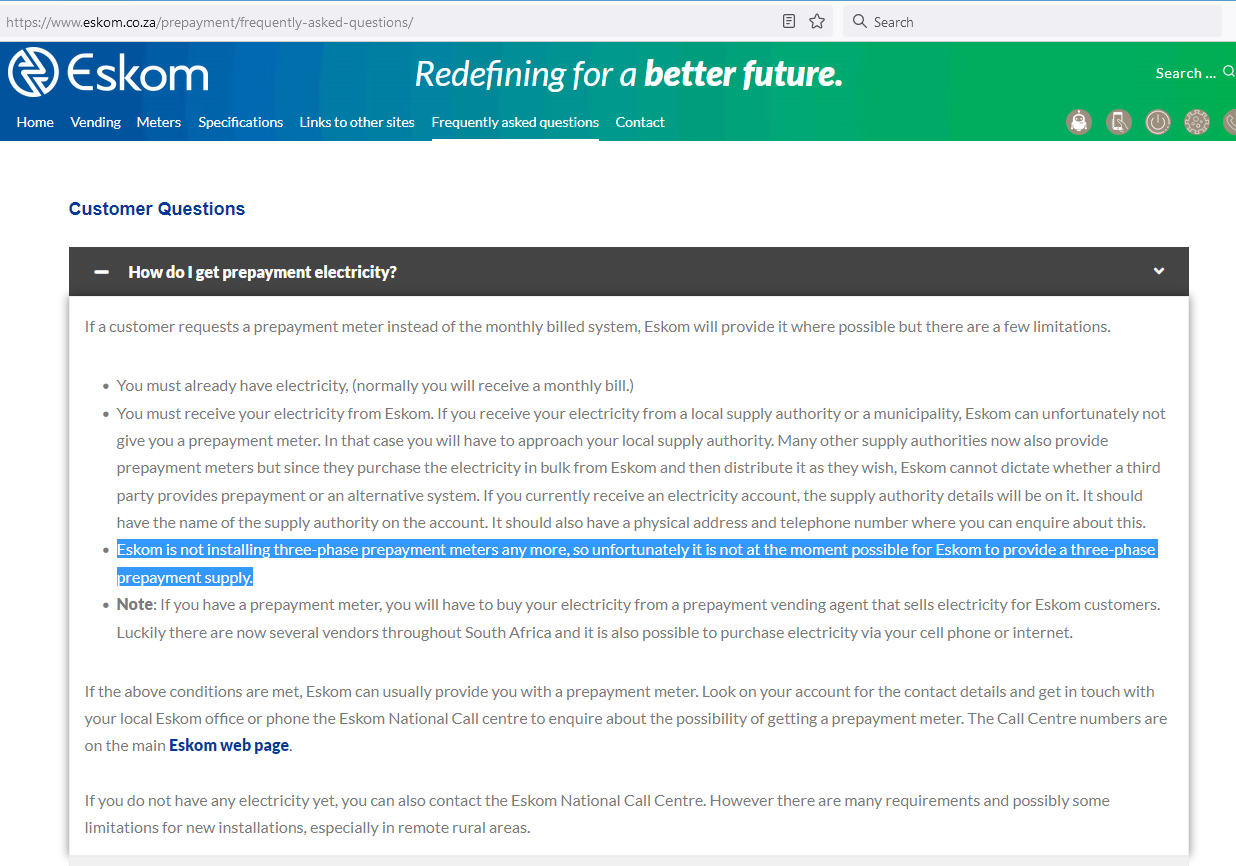

October 31, 20241 yr 26 minutes ago, JaseZA said: We're also hoping to drop the Eskom supply to 80A and use grid peak shaving to ensure we don't trip. Currently paying R15k/month to have 150A vs 80A prepaid with no monthly fees. The cost of the pole and transformer is crazy high unless you're a large business. 😲 I hope you can still get 3 phase prepaid, maybe this Eskom page below is old and not updated?

November 1, 20241 yr 21 hours ago, JaseZA said: Can anyone confirm the size of the AC input and output breakers for a Sunsynk 50kw unit? When I look up the install guide, I'm seeing figures of 200A passthrough and 240A breaker recommended. Not sure about above comments as 50kw 3ph does not compute to 240A breaker. The breaker size input and output for the specific 50kw inverter should be 83A x 1.25 = 103.75A closest standard breaker 100A. Not sure if adequate calculations was done initially before installing the inverter. A few very important questions? 1. What is the original utility 3 ph supply breaker. 2. What is the size of the 4 core supply cable entering the premises( point of supply). 3. Should the supply breaker be upgraded to 100A you should have a 25mm² 4 core armoured cable( SWA) from the utility supply point. 4. Is the original installer/ electrician qualified to work on 3ph supply systems as a normal IE can not supply the COC it needs to be signed off by a MIE or a electrical engineer as these factors could void the warranty. I was just wondering 🧐 Edited November 1, 20241 yr by Derek3
