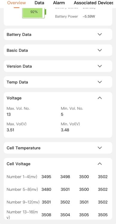

I have charged it up to 100% and then slightly discharged it by exporting to the grid several times today. This led to a noticeable, though slight, improvement. At least this shows that the balancer is working. However, during the winter period, I didn’t allow it to charge to 100% very often.
Honestly it doesn't get better than this. Anything else will be a new product from the Factory. Lowest cell at 3.47 is very close to a full cell.
This type of top float balancing can even be done once a week. In the high end Commercial installations these batteries carry out 2 Cycles a day due to 2 peaks (morning and evening) and once a week keeps them in good shape.

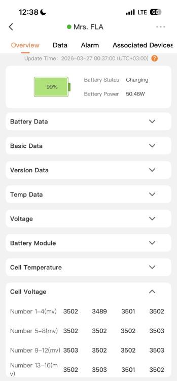

@TaliaB @Stefan Cornelissen @Steve87 @Beat
I’ve changed the requested charging voltage from the battery side to 56 volts. Since then, I’ve noticed an improvement. It appears that the BMS only balances the battery when there’s charging current, and the battery SOC isn’t 100% (maybe).
