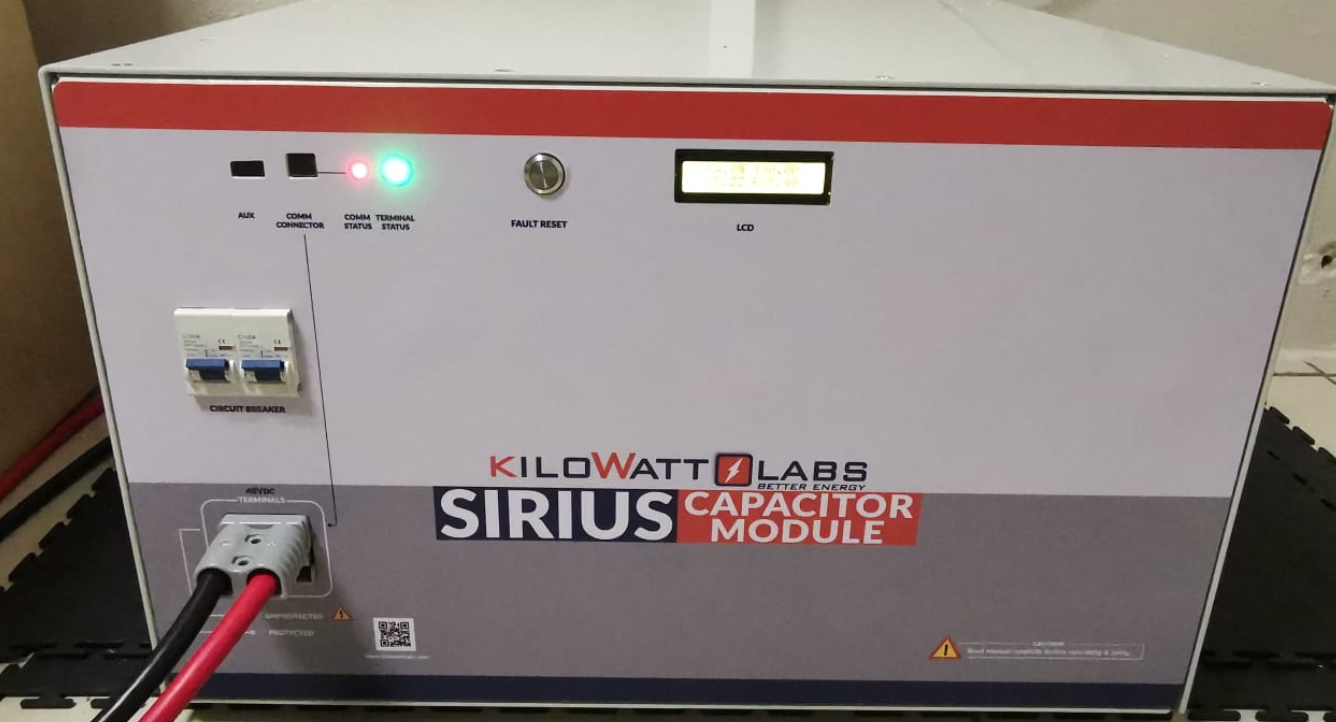

Update: Inverter and PV Ready. Electrical cables (10mm) have been run along trunking.
Tomorrow: Electrical work will be done, moving critical loads from my 3 phase DB to a new SUB DB board. Hoping it will be up and running by 3pm tomorrow.
Then testing of the supercap. I am installing a pylontech 9.6kwh battery bank for a customer so at least I will have something to compare against.

Quick Update
3 Phase is a nightmare if you want to move critical loads to a DB. Finding all the Neutrals is a nightmare( It was wired like crap into the DB). We moved all loads to the new sub db thought we were done on Saturday but started finding funnies:
  1. Earth Leakage would trip on the new SUB DB *Fix*  some neutrals for the upstairs lights going to the the main upstairs DB instead of the new sub DB. Tracked those neutrals yesterday and tripping stopped.
  2. My main lounge lights and study room lights are somewhere going straight to City powers Neutral. Let me explain we ripped the DB board disconnected all the live and neutral wires. We dropped two phases on the supply coming from eskom to prevent voltage from doubling. We run the one phase from city power with live wire on these lights connected directly to the single phase via a breaker. The lights TURNED on!!! This is with all the neutrals disconnected both upstairs and downstairs. I cannot get into the celling for these lights as the house is just built funny. So pretty disappointed about not being able to power the study/work room lights via the inverter. My father will figure this one out as it is beyond me
  3. The F#$ki#& buying never stopped, had to buy DIN rail breakers because every thing in the DB was samite. I did not mind as those breakers are pretty old and we found faults with some of them. The EL upstairs was also faulty from line side it was measuring around 236v on the load side it would drop to 196v *WTF* replaced it and that k@k stopped immediately.
  4. Took the cables to get crimped at a battery shop, the chops used a long nose plier to crimp it. That made me furious. I only feel sad for their customers. I went out and bought another set of lugs for the battery cables, went to 4x4 shop and dropped R800 on a Hellman(Thats what I think its called) crimpers. It Crimps lugs up to 50mm. Crimped it myself and Done!
  5. Only turned the system on yesterday after ensuring that new SUB DB had no way back to the main DBs Neutral. Turned on the battery Growatt powered up. Turned on Panels. Run the house for a few minutes of solar. Configured the growatt. Flipped the change over to inverter. Turned on the breaker on the AC input side and VOILA success!!! System is up and running.
The sirius energy model was at 95% when I powered it up. *Note I am calling it an energy module and not supercap* Switched the growatt to power the house from battery got up this morning and it was at 89%.
So far so good. Will update as I test the system more. I will post pics shortly

I have tested the overload protection charging the module beyond 54.5v and near 54.5v it kicks into over load protection.
Drained it to around 62% this weekend and it still had more to give, did this to see how much my PV power will peak to, by 12pm it was fully charged. PV Peaked to 2450 watts need to start charging the CAP a bit later. (12 x JA Mono 315 watt panels)
Tested grid charging from the inverter @60amps... Thing charges up crazy fast @ 60amps tested from 75% to 100%. Good on the inverter for coping. Would not normally do this as it was just a test.
Washing machine and dishwasher run at separate times during the day to maximize PV power, inverter sometimes taps into battery when PV is not enough and the sirius charges very quickly back to 100%.
Ironing also done at different times same as above but always before sunset, I have seen the Sirius go down to 87% after ironing. Then back to 100% shortly after. And no I am not doing the ironing
Don't ask me about cloudy days I have no solution yet 😂
Going to buy a small kettle 1.2l ratted at 1200watts... As well a LG inverter microwave rate around 1200 watts as well. Russel and Hobs kettle was drawing too much (2700 watt) and funny enough the glass on it cracked this weekend. Hurray reason to buy a something smaller and more efficient.
I think I have been cycling this Sirius module enough and will keep at it. It runs my house from 8pm to 7:30am, at 6am when I leave it usually sits between 67% to 77% thats with us running TV at night for around 3 hours, my home server, my PC, Samsung Fridge, lights, etc. Keeping in mind from 5pm to 8pm I set AC charge to keep the sirius at 100%. This is the grace period for the family to use the hair dryers, microwave kettle etc. From 8pm the loads then switch to battery.
Now time to convert those Geysers to solar..... Watt hungry things
