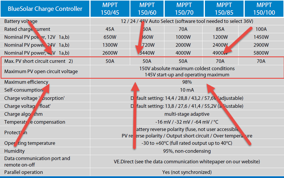

I'll see Phil and Plonkster and raise them both.
It boils down to a very simple line drawn in concrete, not sand: All MPPT's have a max voltage and amperage one can connect to them. Exceed that and they have a tendency to blow.
As an example, here are some of the Victron controllers absolute max, never ever to be exceeded:
