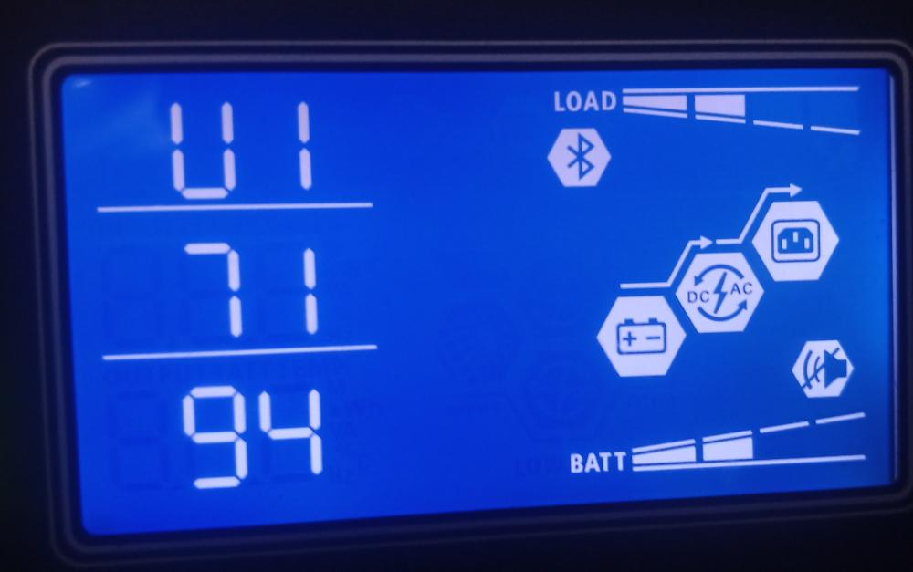

Updated my Axpert King to 71.94 last night, hoping the freeze would disappear. Sadly, today at 13h45 it reappeared for no apparent reason!!!   😞
I REALLY do not know what else to do with this irritating issue
Presumably, because your battery was then full. Of course, that's not a good reason to stop PV production!
So you've verified that the main U1 firmware version is now 71.94?
Verified. Will flash to 72.00 tonight.....   😞
