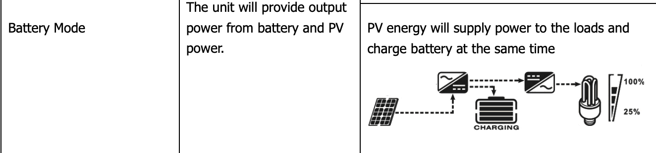

How can i program this setup on the attached pic85390862_Screenshot2019-12-31at10_58_40.thumb.png.0a8b3b11317c6287dd2c8595414d8d8e.png
That's ordinary battery mode. Make sure setting 01 is SBU, and setting 12 (back to utility) is not too high. There are many posts with recommended Pylontech settings.

HI @Coulomb sent the wrong screenshot i meant the one below:95381792_Screenshot2019-12-31at14_38_13.png.41ff4913d3989e2e57eadfa312797572.png
I'm not aware that your Axpert MKS can perform in the mode shown, with no battery present. I thought only the models with the 450 V or 500 V max PV voltage could do that.
Do you have an online link to the manual with this image?
11 hours ago, Coulomb said:
That's a manual for an MKS II, you said you own one with a 145 V max Solar Charge Controller. They are different beasts, with different capabilities. Yours cannot run without a battery, the MKS II can.
Eish that's bad, so i need a new inverter, i have taken pylontech recommended settings and applied, but the inverter is now complaining error 4 ( battery voltage too low)
