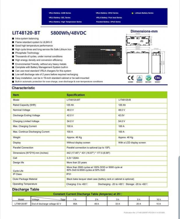

Early days but rather disappointing that the bms is not compatible with the victron although both are CAN. I got them half price so that should have been a warning signal. The Solar Warehouse, say no more?! Problem if you on pension and finances don’t stretch to pylon or b box...
battled to get information as they were sold as Li-ion Tech battery lit 48120B but they actually ESM 48100A1 from Huawei. So i could get more information. But that don’t help, they don’t even communicate on their own bus to each other.
i am using the multi built in bms, when finances are settled i might add a bmv 702. Or try using the digital outputs on the battery into the 2 contact assistant bms in the ess.
I re did all the ess voltage settings to match the Huawei manual. Now I have it working very well and my calculation of Wh out of the battery and change in soc match. So far so good, don’t need the CAN bus to work the multi and CCGX is doing it well enough.

Hey Keith, interesting posts - you have made good progress and I'm sure you're enjoying your energy independence!
My lead acid batteries are failing, I'm considering the "LCB" li-ion batteries being promoted on sites like Solar Wholesaler, Solar-Boks, Solar Energy Zone etc. The price makes them very attractive (R15k for 6kWh). The spec sheet refers to them as "LiT48120-BT" which appear to be the same (or similar) to the ones you have installed.
Your system has been running a few years now, have you experienced any failures with these batteries? Would you recommend them to a friend?
