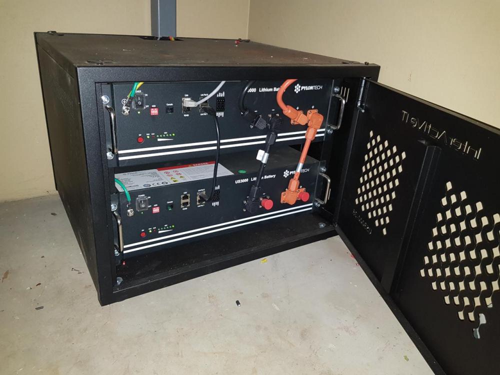

  • 2 x US3000 Pylontech Li-Ion Batteries
Just as info. The battery's is actually not connected to recommendation. The black(negative) wire from coming from the  inverter should connect to the negative pole on the bottom battery. See illustration below.
I know on two batteries the charge/discharge imbalance might be minute if you keep it as it is, but something like that will drive me crazy eventually and I would end up fixing it.
