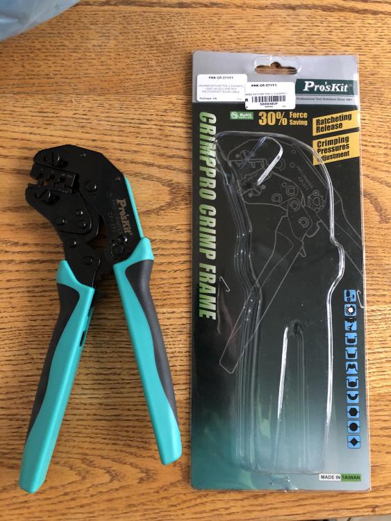

2 hours ago, Arandoza said:
Just got one today at communica, around R700
Nice, thanks for sharing, dont get them at that price anymore. I bought one for just under R1000 about 3 years ago, I saw a similar one last week selling for over 5K.
And if you think of it, its nothing else than a normal open winged terminal crimper.
@Dougiedanger Haven't seen a crimp free MC4 connector. Share a link?
Agreed,  Am also looking for a place to get the Solar Spanners - The Plastic ones :)
The crimper Also has a large range of DIE sets available, as well, for ethernet, RG59, and other various electrical connectors etc. I was quite impressed and the Crimp on the 6mm seems to be HUGELY better than the ones I did previously with other General Crimpers.
The only thing I would like to find is a Crimper DIE set that can handle 10mm Solar Cable? but have not found that so easy to find.
