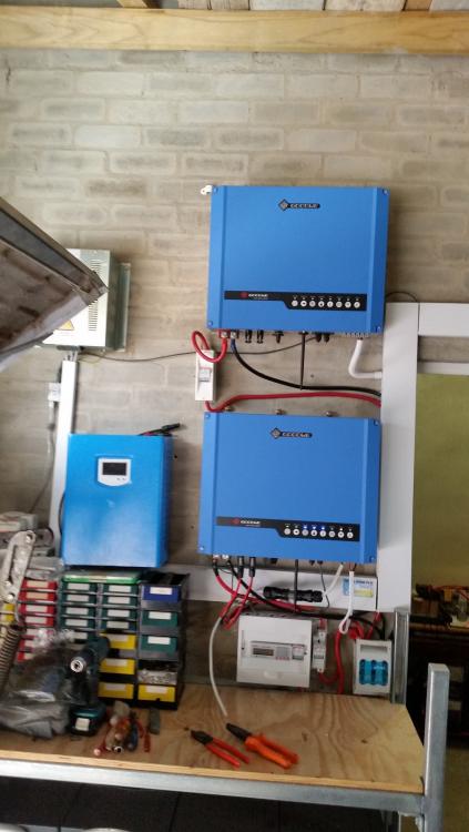

The 5kw Infini has failed again with an error 27 fan fault. it seems to reset itself after an hour 10min and then works again as if nothing has happened. boxing it and taking it back. they can either replace the unit or refund me...just need to go read the comsumer protection act...

I am taking it back on Monday, either want a replacement unit or a refund..... so in a meantime i have started firing up the twins.......

got two of them running giving me 9.2kw available......going okay so far, but thinking ahead again for the next test
