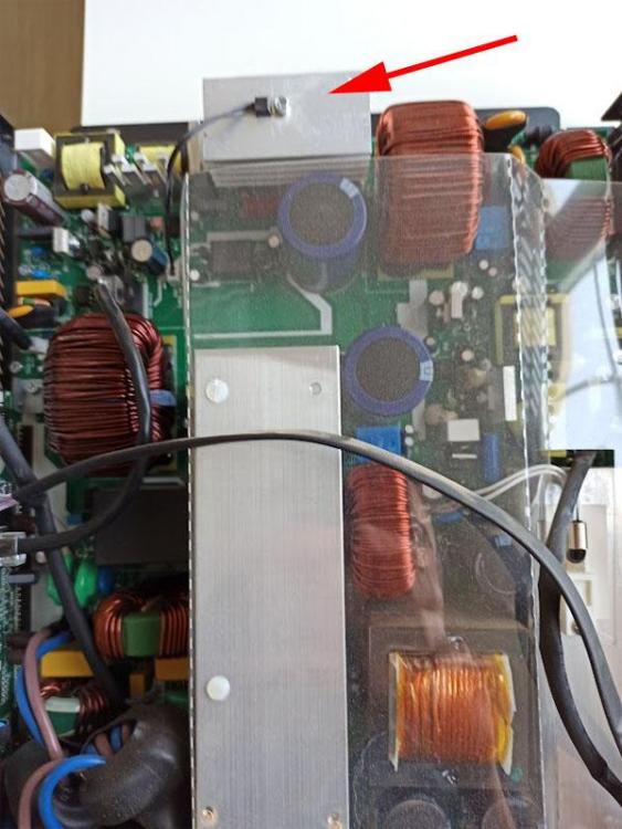

August 19, 20215 yr I now installed the Noctua NF-8 FLX with airflow from the bottom to the top. Before installing the new fans I found that the uppermost heatsink (DC/DC converter?) was very hot. To solve this problem I installed a third Noctua with seperate 12V supply. It´s now running permanently with 2000rpm. The heat accumulation in the top of the chassis has been solved and noise dropped down dramatically

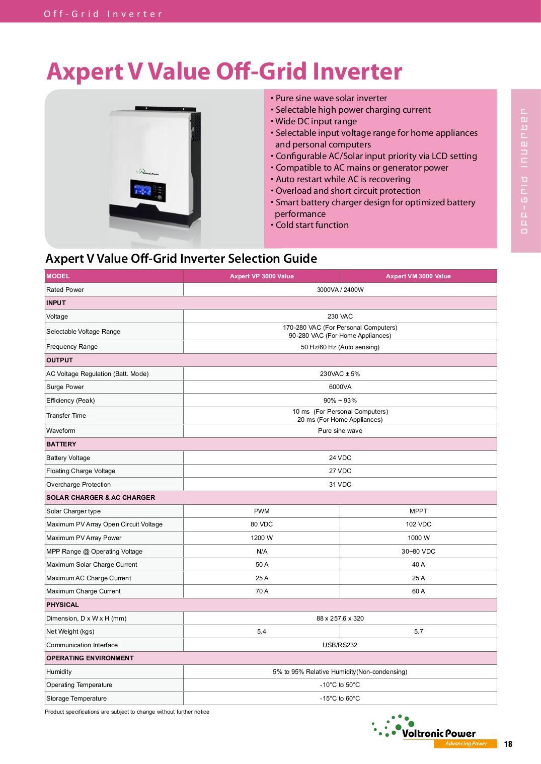

September 27, 20214 yr On 2021/09/10 at 3:41 PM, Coulomb said: No, these small models don't seem to have PWM controlled fans. Does the same hold true for Axpert V Value models (3000VA/2400W)? Datasheet attached.
September 28, 20214 yr 9 hours ago, Kilowatt Power said: Does the same hold true for Axpert V Value models (3000VA/2400W)? Datasheet attached. I don't have any firmware for these models, so I can't be sure. But my guess is yes, inexpensive fan control seems to be one of the hallmarks of the VM models. Edit: that means I'm not sure about the original poster's model, as his is clearly called a VM model. Edited September 28, 20214 yr by Coulomb

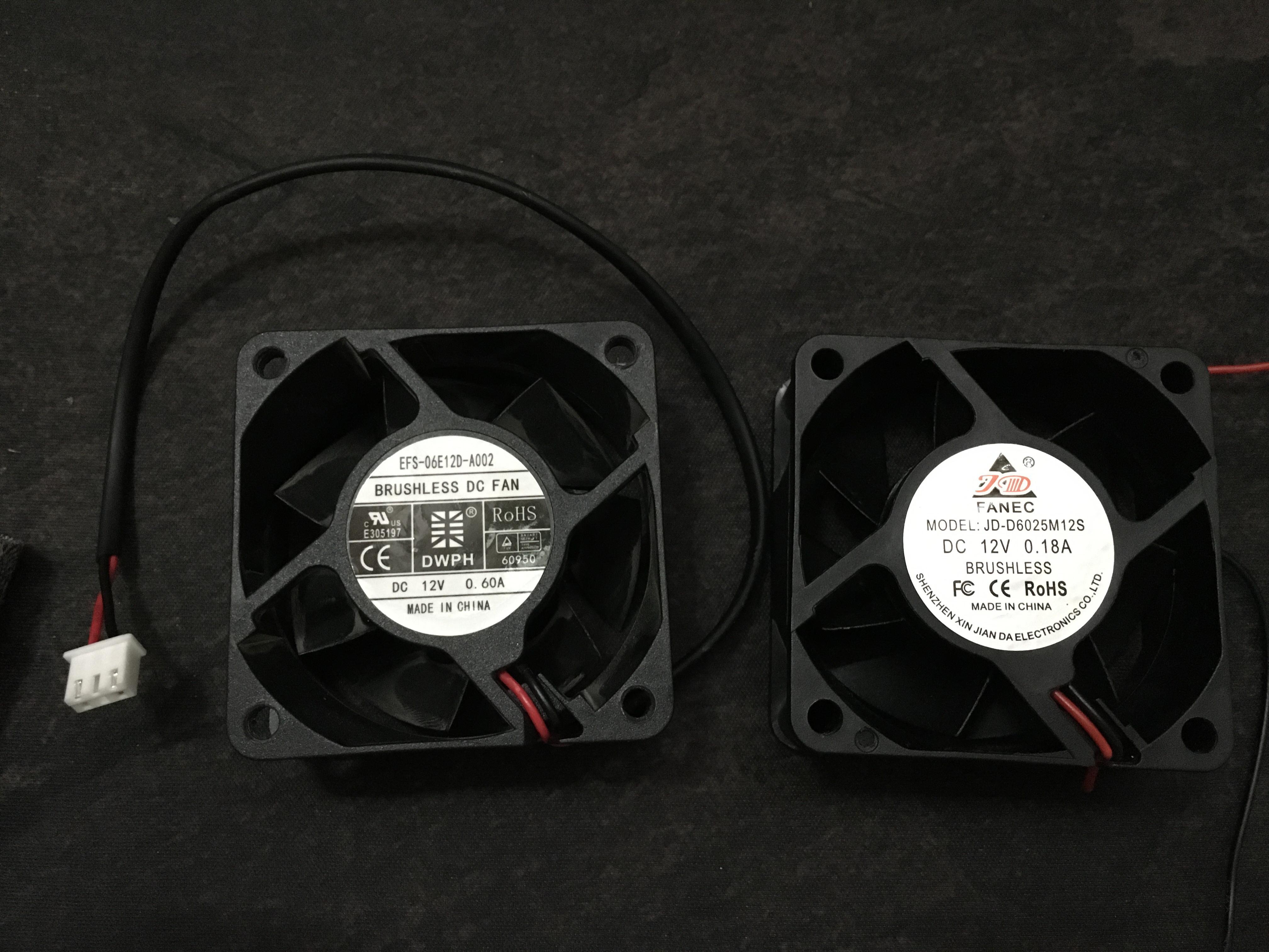

September 29, 20214 yr I replace Original Fan (0.60A) with (0.18), it is can do the job with a little noise. I think 1KW firmware need fix for fan, temp, measures, solar input, charging speed and many things... no problem but I thought it is a better of that but still good enough for me. and like any company it is support only new products for few months or no support at all.
