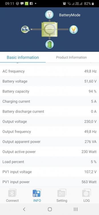

Observation after reflash.
So it's a grey Durban morning, and my PV input is about 80W.Not near what the house requires, and it pulls from utility correctly, but, it goes to full amps (50) charging in short bursts, not reaching my bulk charge voltage of 57.6,then goes back to discharge. I thought this would do a full charge and then only discharge,instead of these quick bursts. Not sure if that is due to my back to discharge value or any other value in my settings, which I have attached. @Coulomb @Calvin@Calvin can you guys please explain the logic of how this works to me?
Here's something else I noted.. Its not even close to bulk voltage, but it seems as though it has stopped absorption charging. Maybe I don't understand the charging as well as I should..?
