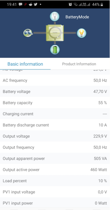

So I had full charge today (Solid charge light), and went on batteries just over an hour ago, and its currently at 83%... Something not right.
Usage is 10A, battery bank is 800aH, Back to grid at 50%.
So, according to the inverter, with a solid charge light, it was fully charged. See attached for 2 hours later...
The usage was constant. I made sure to not have anything besides the standard on.
Don't forget that with a lead acid battery and no BMV (as yet, is that right?), you only have the inverter's estimation of the battery SOC. Especially in float stage (CHG LED on solid), it is quite inaccurate. During charging (CHG flashing), it's not too bad, but still very approximate. I would not be concerned about 83% on float, depending on the battery voltage.
PV input power zero. If there was any sun, there should have been some PV. So there is definitely something wrong there.
