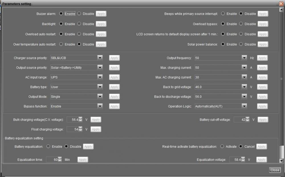

Hey guys, I have 400ah (48v) batteries installed on a 5kva Axpert King, but noticed my battery capacity dropping very fast. 2 and a half hours after sunset, with the batteries fully charged, it went over to Eskom.
I have attached a screenshot of my settings, unfortunately the video taken from the app is too big
Please help,

  • Sadly‚ 46 V is the default. I'd certainly not want to go below 48 V for lead acid; I'd want to stop at 50 V rested, which might be more like 48 V under load. @JohanDbn, did you regularly let the

I am not sure about your back to grid voltage setting. 46 is too low in my opinion ( @Coulomb?) . I would not allow my battery bank to go down to 46volts.
With Trojans and most other Lead acid batteries, if you reach 46 volts while drawing 500 watts, they are either undercharged or old and on their way out.
LAstly, voltage is not an accurate indication of SOC, but in this case I worry a bit.
Try and measure the voltage across each battery when they are at rest (no load and not charging). If there is a big difference on one or a few of them that may indicate a damaged battery.
@JohanDbn, did you regularly let the battery discharge till it cut off during load shedding? The 42 V default cutoff for lead acid (10.5 V per 12 V battery module) is a theoretical state that should not be visited ever, except for coming up with a marketing capacity for the battery. Just a few excursions that low will ruin a lead acid battery.
That plus running down to 46 V before switching to utility has likely worn them out.
It's really sad how easy it is to ruin a lead acid battery, and how the specifications and inverter-charger defaults are designed for longer run-time (during warranty) and shorter life.

This was the first night I ran them,so fortunately I would not have caused damage. You suggest I increase it?
Based on the manual, I should be getting much more backup time than 2 or 3 hours. All I want is for these to carry me through the night on base load,looking at my installation that should be possible.
Yes. Perhaps try 48 V. Unfortunately, that will cause it to switch to utility even quicker.

That's true. But it says on the front of the battery module something like (forgive me if I misread it): "Constant current charge maximum 60 A". With two strings, that's 120 A max. I suggest cutting it back to 100 A because of the Axperts' well known tendency to overshoot target battery charge current. You'll likely never see more than 80 A anyway, and that would only be on good solar days an hour either side of noon. But as I mentioned, the maximum charge current is used to figure out the "tail" current (when the charge current falls to this value, the battery is pronounced full). It's basically the setting divided by 5. So 100 A / 5 = 20 A, or 10 A per string. Leaving it at 50 A means the tail current is 10 A or 5 A per string (hence per battery module). Ironically, having this figure too low could mean you overcharge your battery, because with fluctuating solar input, it might never get the charge current down that low, and stay in absorb mode all day.
I found the specs for my batteries. So looking at this, i see they have 6 cells, and cycle use is 2.4 *2.45VPC.
Does that mean my float should be (2.4*6) * 4 batteries in series = 57.6 ? @Coulomb
What should my bulk charge and float charge here be? Im planning on leaving them on charge for the weekend.
I have attached all the information I got....
wrt to software, have I got the latest, or should I upgrade?

On 2020/07/11 at 1:10 AM, JohanDbn said:
I found the specs for my batteries. So looking at this, i see they have 6 cells, and cycle use is 2.4 - 2.45VPC.
Yes, that's correct.
You should use 57.6 for the bulk/CV/absorb voltage setting (setting 26), and you can leave the float setting at 54.0 V.
Main firmware version 71.92 is quite recent, probably more recent than any I have collected. I would not attempt to update it, unless you feel the need to fix the premature float bugs. In that case, you should consider patched firmware version 73.00e (but not factory firmware 73.00; there will be an issue with fault code 90 in 6 months).
@Coulomb I set it as you suggested, heres my latest findings.
Top and bottom bank battery voltage:
Battery 1 : 13.11
Battery 2: 13.13
Battery 3: 13.50
Battery 4: 13.56, so these seems to have settled in decently.
At the time my panels lost solar, it was at 100% charge,53.3V. My average usage hovered around 500W. This was at 17:30.
At 19:30 , i was sitting at 42%, 46.4V
That means, at minimal load of about 500W(10A on 48V), i got 2 hours backup time, instead of the expected 18(ish) on 400ah with a switch to utility at 46V
Now also to note, the moment i went back to utility, the battery capacity  shot up to 90% within 2 minutes.
Now with the batteries fine, could this be a faulty inverter? Could the inverter be pulling crazy amounts of power? What else could this be?
Could it really be that the batteries discharge in 2 hours and recharges in 5 minutes at a 10a charge?
I have attached screenshots with the numbers, as well as my current settings.
Edited by JohanDbn

It's looking hopeful, but I'd like to see even better balance.
Quote
You seem to be putting too much faith into the SOC reading on the inverter. Any value higher than 42.0 + 10.2 = 52.2 V will be called 100%, even though that's only 13.05 V per 12 V module, which is just getting started if charging. So get a good SOC reading you need a battery monitor such as a Victron BMV, or observe the battery voltage near the absorb voltage (57.6 V) for well over an hour, until the charge current (while the battery voltage is near 57.6 V) falls to about 10 A. It would be great if you could watch your charge (middle, green) LED during the day, to see if it stops flashing before the above conditions are met (i.e. the battery is truly full).
It looks like we can lightly patch main firmware version 71.92 for Axpert Kings soon. The only hassle is we can't show a decent version number, as the version display is controlled by the MCU (display/BMS) processor, and it only accepts 4 numeric digits. I get a strong feeling that this is the basis of your problem.
As a point of interest, what is your display/MCU firmware version number? It doesn't seem to show on the Android app. It will show blow "U2" when pressing the up or down buttons on the inverter. [ Edit: oh, I see it's 02.40 from a Watchpower screendump. That's plenty recent enough. ]
Quote
Actually, that's an average of 46.4/4 = 11.6 V, with presumably lightish load (500 W or so). I would guestimate that at more like 25% SOC.
Quote
Hopefully, it's just because it's not charging properly. I'm short of time at present; did we try temporarily just increasing the float voltage setting (setting 27) to about 57.5 V? So then it's basically the same as the absorb voltage, so if it goes to float prematurely, it still charges? There is then a risk of overcharging your battery, but that seems to be the least of your worries just now. If runtime improves dramatically, then you know it's the premature float issue.

After load shedding is over (is that being optimistic?), you should increase the voltage in setting 12 to say 48 V. That will increase the life of your battery by not discharging it too far after poor solar days. But leave it at 46 V for now, otherwise it's more difficult to compare situations.
@CoulombThanks for the reply. I changed float to absorb, and then one battery shot to 17V, and i promptly took it back down again.
What I have noticed, is when I charged it via AC overnight, it did reach the absorb voltage. I then had better performance at night. It lasted me from 6pm to 4:30am. That clearly is not yet ideal, but far better than the 2 hours I got previously. To note, we also had the washing machine on while on batteries, which wouldve taken some standby time off, so its not a clear reflection on a constant amperage.
Noticed a 20% drop over4 hours, from 100 to 79, and then a major drop in an hour from that 79% to 65%. Bearing in mind the inverter may not read the SoC on the batteries correctly, the inverter is the one making the decision on when to go over to utility again, any idea what could be the reason for this drop? The load was not increased, to the contrary, the load actually decreased, as we were heading to bed. Could it be ambient temperature related?
To mitigate the float charge bug, i dropped my max charging to 10A, and waited an hour after sunrise to bump up themax charging amps. At last check it was hovering around the absorption voltage at 11 amps. If my knowledge of charging is correct, I should now start seeing a gradual drop into the float mode?
That should leave me at float voltage at sunset, and with (hopefully) no larger appliances running tonight, I can get back to you tomorrow on a more realistic standby time on an average of 10A/500W.
[Edit: It did go down, and now hovering on a trickle charge of 3A around float]
The night i only got 2 hours, I cannot remember seeing it going higher than the float. That may well be a setting issue, as I had max AC on 2A (SBL/UDC) and max charge on 50A, which if im right is the perfect setting to trigger the bug if it carries that into sunrise?
The floating bug issue.... Flashing the inverter to the one you linked to may be a downgrade on the firmware? Is that advisable , or should I rather just play around on the voltages to mitigate the floating voltage bug until the patch come out? Is there a way/site where I can see when this comes out? I did not see any downloads on the voltronix site.
Hope for the best, prepare for the worst.
As for poor solar days.... I live in Durban, what are those? lol
Edited by JohanDbn
Eek. It sounds like your battery modules are very out of balance.
Quote
Yes, the premature float bug doesn't show up with AC charging, unless you change the settings to unusual values; then it will happen even with AC charging.
Quote
The rest might be due to the imbalance.
Quote
So 79% on the guess-o-meter represents about 12.5 V per 12 V module, a moderately charged state, perhaps even around 79%. But 100% on the guess-o-meter is just over 13 V per 12 V module, which is a state that won't last long and will quickly drop to around 12.8 V (if fully charged) or lower. So that is probably the reason for the initial sharp drop.
65% SOC GOM is around 12.2 V per 12 V module. With a light load, that might represent some 50% real SOC. That's a pretty fast drop, and suggests to me that one or more of your modules is running out before the others.
See if you can find out which one(s) are sagging first, and try to charge them separately with an automotive charger of some sort. Unless it's a particularly beefy charger, it will take hours to shift the needle on those. After say 8 hours, let it rest an hour or two, and compare with the voltage of the others (preferably take one string out for this, so you have some rested modules to check against). If it's still below at that point, give it some more hours. You may have to do this for the second worst and even more. Once they are close (withing 0.1 V certainly), put them back in service and see if that improves things.
Quote
Temperature certainly affects lead-acid battery voltages. I'm rusty, but I think the voltage should rise as the temperature falls.
Quote
The current should gradually drop, yes, but the voltage (if the sun permits) should hover around the absorption voltage until the current falls to below 10 A (your 50 A from setting 02 (I hope I remembered that correctly) divided by 5. Then the charge current should briefly go negative, the battery voltage should fall to around the float voltage, and it should bump around that value for the rest of the day.
Occasionally, after a big load, it might go to zero charging for a minute, then back to bulk charging again, heading towards the absorb voltage again.
Quote
That sounds about right for maintaining the float voltage.
Quote
I don't understand this. You mention setting 11 (maximum utility charging current) set to 2 A, but this seems irrelevant as you had UDC (Utility Disabled from Charging). What is being carried into sunrise?
Quote
Yes, it's downgrading the firmware. You can in this instance put it back, actually to a slightly later version than what you have now: Axpert King main firmware version 71.92. Or of course wait till the patched version comes out, but you have the factory firmware in case it gets delayed.
Quote
I suggest you try and sort out the imbalance issue first.
[ Edit: I meant to add that a lot of the King firmware changes lately seem to be focused on lithium batteries with BMSs. Since you are running lead acid, these changes won't affect you, so regressing back to a lightly patched version of 71.80 should not cause you much concern. However, there is a small chance that the format of the data exchanged between the main and remote display firmware may have changed in some way that will affect you. But if that's the case, you could also regress the remote display firmware to version 02.00, an upload by user RichieRich. ]
Quote
Voltronic Power no longer provide a site to download firmware, after the clones came out with Voltronic firmware in them. Keep watching the files area of this forum: https://powerforum.co.za/files/ .
