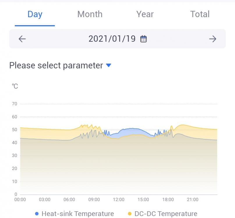

I have just installed the 8kw Deye which is similar to sunsynk but I must confess that the guy is pretty loud, louder than the MPP GK that I replaced and it even comes on at lower lower loads. So am wondering is there could be something wrong with my set-up.
I have my CT placed quite close to the inverter, could that be the reason?
Which of the attached temp triggers the fan? DC or AC?

Both would trigger the fan. The DC would trigger at 55° and the AC would trigger at 50°.
This is my temp reading from yesterday.
