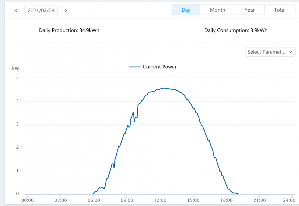

Thanks KM
Interesting comparing the two graphs
  • I am at 33deg 41 south  north facing roof at 30 degrees
  • 12 x JA Solar 405W Mono Panels
  • Sunsynk 5.5 Kw
Yesterday was a hot clear sunny day
Max power produced 4.55 kW
image.thumb.png.51c8a034a4e1ab6773de5c1e09a4714c.pngAnd for the day 34.9kWh
you have to take these apps with a grain of salt, i am using Solarman and Solarman Smart, the reading on the SUMMARY can be different from the reading on DEVICE in the same app, and the two apps can be different from each other.

You are doing very well!
from a PV system of 12*405 = 4,860W, you generated 7 times you solar panel Watts installed for the day. Usually , depending on the season an average of between 4-6 times is achieved!

But as other commentators said "take it with a pinch of salt

Highest i got in Somerset West was 7.2.
Currently averaging 6.4 with the wonderful Somerset West sun this time if the year. August it was down to 5.4. Interested to see what the first full winter will bring. Hopefully not less than 4.
