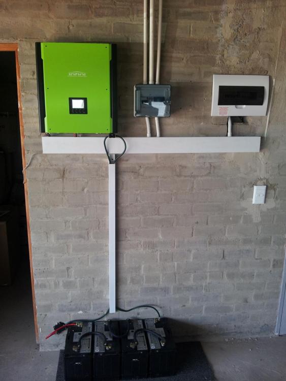

Ok, at 6am this morning I removed my Grid tied solar system and replaced it with the latest tech......a Hybrid grid tied inverter. Now Eskom can fly kites.
I am grid connected, using solar power and grid AND battery backup. Fully computer controlled and programmable with many options.
Just have to get more batteries when i can.

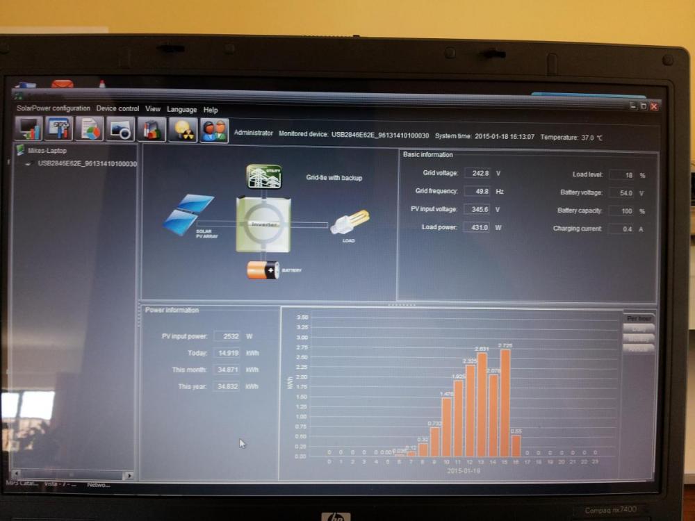

a screenshot of my inverters software running of the network. been smooth now for the last two days, so i think i can return the keys for the municipal / my paid for street box
