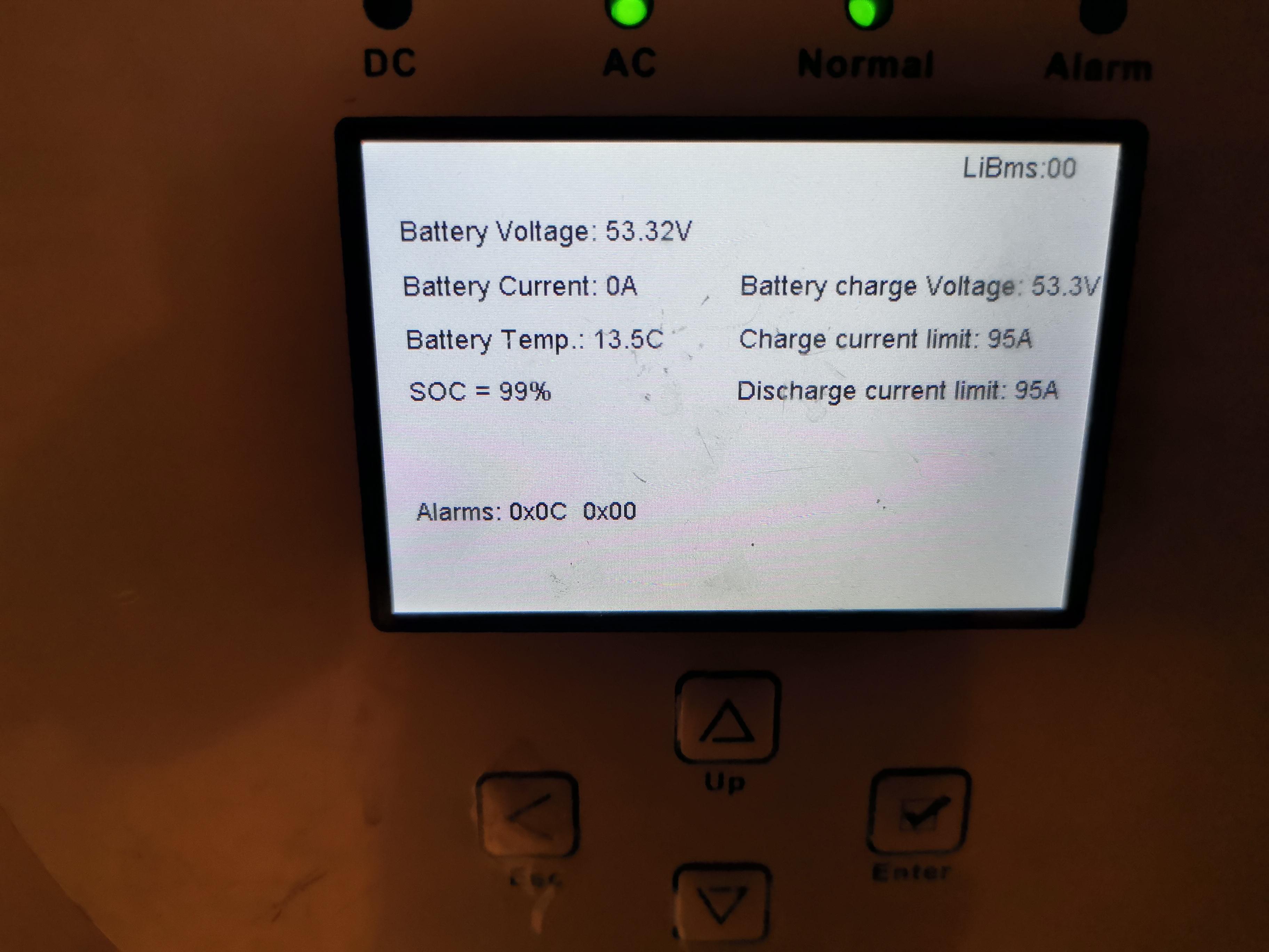

April 29, 20215 yr Author So it seemed to behave during the day so I left it but at night.... I will try swap the cat5e cable tomorrow? Here is the libms screen.
April 30, 20215 yr 11 hours ago, Dani said: So it seemed to behave during the day so I left it but at night.... I will try swap the cat5e cable tomorrow? Here is the libms screen. That's the fault code screen, not the LiBMS screen.

July 17, 20215 yr Reviving this thread. Are you using a RIOT? I noticed that your LiBms reads 00, which is what mine reads when I have the RIOT connected. When I connect battery directly to the inverter, it shows LiBms:01, as well as SOH next to SOC.
July 21, 20215 yr On 2021/07/17 at 10:26 PM, Saliegh said: Reviving this thread. Are you using a RIOT? I noticed that your LiBms reads 00, which is what mine reads when I have the RIOT connected. When I connect battery directly to the inverter, it shows LiBms:01, as well as SOH next to SOC. Is this on a Sunsynk and AM-2 combo? Which firmware are you running? Using CAN or RS485? Please post your battery settings screens as well as the Li-BMS screen. Thanks

August 15, 20215 yr Author Using hubble Am 2 with sunsyk 5.5 No riot. @swazz99jhb Sorry for the late reply
August 15, 20215 yr Funny how these Hubble's differ. Mine is sitting at 125A yours at 95A. I thought you could see the HOC? I've seen some of the guys posts showing it. Not sure if their hubble's are newer or just newer firmware. Think I'm scratching an itch that doesn't itch. My setup works 100%
August 16, 20215 yr 15 hours ago, swazz99jhb said: Funny how these Hubble's differ. Mine is sitting at 125A yours at 95A. I thought you could see the HOC? I've seen some of the guys posts showing it. Not sure if their hubble's are newer or just newer firmware. Think I'm scratching an itch that doesn't itch. My setup works 100% It gets those values from the BMS, so it's dependent on the SoC, SOH etc.
