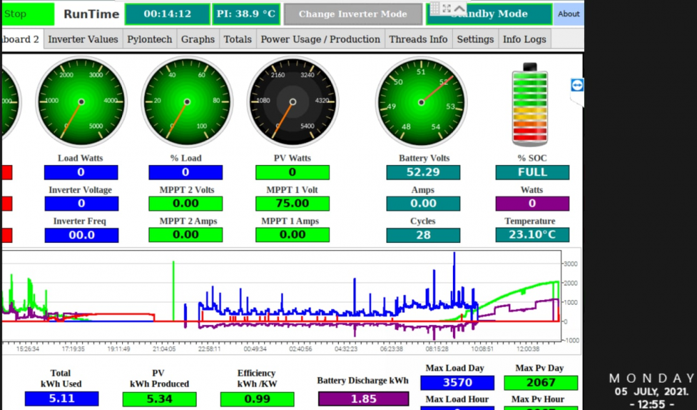

July 5, 20215 yr Author To illustrate what happens, here is a snapshot of my nightly system (System 2). The batteries were on 68% when the panels started generating watts. At around 10h18 the daily system (System 1) sensed the batteries were full and turned on the excess feed to the nightly system. The charging rate was upped by around 8 Amps whilst the solar rate was still low, but climbing. As System 2 is limited to 10A grid charge input, this will not go higher than 10A from the grid supply as to not overcharge the PylonTechs. That energy would have been wasted otherwise, however, I am able to store it in the second battery bank.
July 5, 20215 yr Author 1 hour ago, 87 Dream said: Great setup Sass. What makes your system really good is that you still find a safe & longterm use for the Lead Acids. However, it's quite a complex setup that most people would avoid. You basically have two independent systems. In a parallel Axpert setup you can achieve the same results. However, you cannot mix the Acid & Lithium Batteries except if you had a DC Changeover switch. Great way to at least keep the Lead Acid batteries providing energy storage. Very interesting setup. Thank you for sharing 🤓🤓 87 Thank you. It is an interesting way to harvest energy which I don't think many people use. With parallel inverters I would not be able to do this. At the moment I am loading the bejeezus out of the system to test & see to where it can be pushed. Washing mashine and dryer running together with the rest of the household demand, and even still getting good energy into the nightly system. Right now I am checking cables to see if these are overheating and all, and nothing. Interestingly the 6 PylonTech batteries are rapidly filling up. By 13h00 all systems will be fully charged up. This means there are still scope to get even more from the system. I really think this is not bad for a coldish winter day in the Cape. Here's the present situation Edited July 5, 20215 yr by Sass
July 5, 20215 yr Author And just before 13h00 the 6 PylonTech batteries are fully charged. Whilst at the same time the 12 AGM batteries are also literally full and still supplying household demand. The result of this is that I am getting the most out of my system, with minimal effort and with a lot of overhead to spare. Here I show some of the images of my installation. When I took these it was still a bit of a dog's breakfast. I have since cleaned up the roof cables and trunked them. I need to make space for the inverter installation and clean this up properly too. The Arduino units are installed in a box behind the Victron battery balancers. Not happy with the external cabling, and need to work on those. That's next on the list. The PylonTechs are in a steel cabinet with removable panels that I built myself. It is on castors to enable me to move it around. The different solar panel orientation can be seen from these photos.
