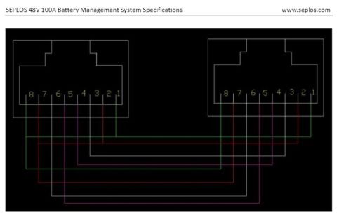

I found this pin-out diagram, but I am unsure if the RS485-A and B should go to more than one pin on the RJ45 connector?
This RS485 converter does have a ground lead, should also be connected to more than one pin, as per the diagram?

He shared the in-out of the cable he uses for the Shoto batteries as well as the software needed.  I never tested it, but here are the pictures of the RS485 cable.
It looks to be pin1 and 2 on the RJ45.

Once I found out that the shoto uses a Seplos 100A BMS I managed to find a ton of info on diysolarforum and on boards.ie, so shout out to those guys over there, they've done a lot of research on the seplos.
The pinout is as follows: Pin 1 on the RJ45 plug goes to B (D-) on the adapter and pin 2 goes to A (D+)
You can also use pins 8 & 7 (respectively) instead as the pinout is mirrored on RS485 port. I've actually used 1&8 for D- and 2&7 for D+ for a better connection with these flimsy wires as they are joined anyway as per the image below.
The software needed to connect is called "Battery Monitor V2.1.8" by Seplos and you can find all the necessary info and files here: https://drive.google.com/drive/folders/10pxgNLHovcDZRVGrCZsSkfecBrRw-AdW
