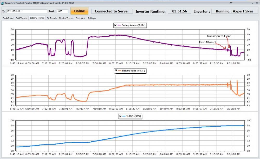

  • Just some feedback on firmware version  72.70:  If you have been following Coulombs posts, you would be aware that the original firmware from Voltronic, comes with a charging bug. That is why the

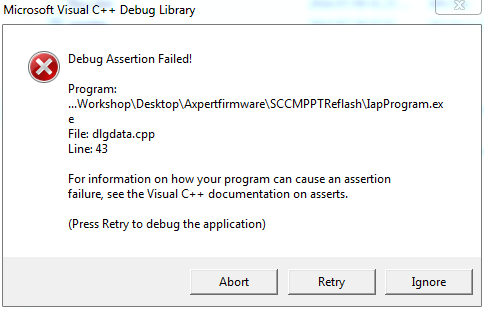

8 hours ago, Coulomb said:
I Googled this error, and came up with:
"Most likely you have a DDX call to an control ID that doesn't exist on your dialog. Did you delete anything from your dialog and not delete its associated member variable?"
(DDX is Data Exchange, old Microsoft terminology).
Poking around in the code confirms this. So most likely there is a bug in the upload code (all original manufacturer code, not patched) that is normally not invoked, so it doesn't normally get seen (and hence fixed). My guess is that it's to do with a dialog that has been removed, and that would be the one for the comm port. I think they had a lot of trouble getting the code to work with a selectable comm port, and thought to hell with it, we'll always use COM1 and make the user change their comm ports to be COM1. Then they forgot to delete some code that references the now deleted comm port.
You state that you followed the instructions... did you somehow forget to change your USB to serial's device to COM1? This applies only to the SCC firmware updating; the DSP firmware (72.70b) updating uses a totally different upload program, which allows for COM1-COM9 (but not COM10 and beyond).
Mind you, when I just tried running it with no COM1 present, it just said "Invalid port number" and didn't throw up the assert failure. So the light works fine in my office.
I tried running it from a folder with a space in the name. No assert failure.
I don't suppose you have Visual Studio (free "Express" or "Comminity edition" is fine), so you can press "Retry" and see the call trace, and post it here?

Well, it would be better to write the upload software properly so it can use any comm port up to 99 (or whatever the practical limit is) , but that's not an option with what we're provided with. The SCC upload software is hard wired to only use com1, period.
I've never seen Com1 in use by other hardware, it seems to be reserved unless you have a real (non-virtual) comm port. So that mitigates the forced use of com1. But with millions of Windows PCs and laptops out there, I can believe there could be exceptions.
I don't know if the use of com1 implies certain other resources, such as IRQ vectors or memory buffers with particular addresses. But library code should be dealing with those issues automatically.

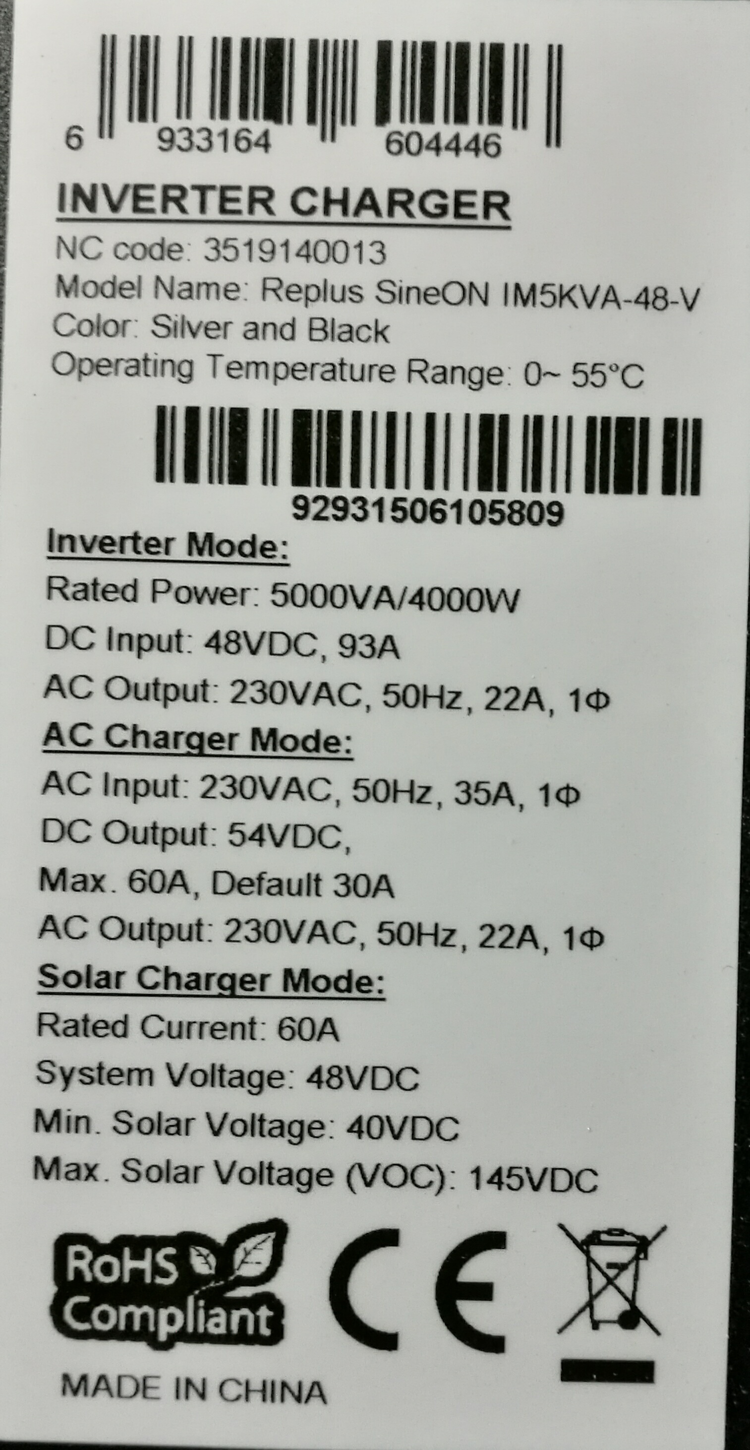

13 hours ago, fritserasmus said:
I(s) this inverter good for the 72.70b?
It sure looks good to me. But to be doubly sure, what are the two existing firmware versions (DSP, U1, and SCC, U2)?

1 hour ago, fritserasmus said:
The firmware versions are:
UI 72.40
U2 04.00
Ok, that pretty much clinches it. You should be fine with 72.70b Pb firmware. Just make sure you don't try to set setting 02 (maximum total charge current) to 60 A or lower, or the SCC will refuse to charge from solar. You could update to SCC firmware 4.10 to fix this, but it's not essential, and SCC firmware updating is a little harder.
