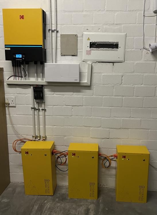

Installation was done last week Thursday, 1 x Kodak OG 7.2, 3 x Kodak FL5.2 batteries, 15 x Canadian 540W panels on 2 x strings feeding the full house. Decided NOT to connect the 2 x geysers at this stage .... maybe in future .....

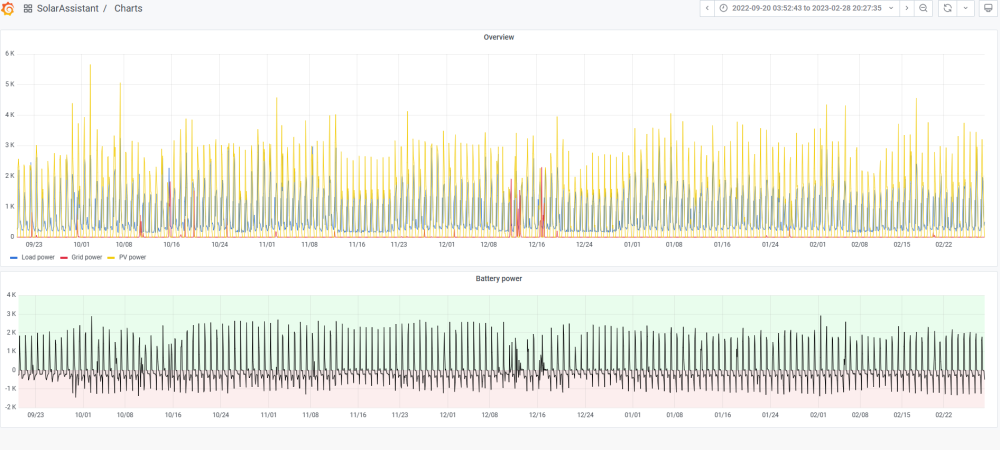

All up and running well, still based on installer / default settings. I'm happy, but will be looking to optimise my usage / settings etc from here on in. So now I'm ready to start my solar experience ...... and for that I'm going to need proper monitoring / data capturing software etc. How do I get to speak to someone from Solar Assistant ? (E-mails via their website are not being answered ....) I have already searched and read what was said around here. Also looked at Hubble, but from what I could understand it is not going to do what I want to do ....
  1. Data log "everything"
  2. Download to laptop all
  3. Do settings etc over wifi / internet / USB
  4. Do monitoring / setting from my desk via WiFi ..... laptop
  5. All data etc need to be real time ..... I'm not interested in logging data only at certain intervals.
  6. etc
Yes, I want my bread buttered both sides ........ as much as this is a necessity and a tool .... it is also my latest hobby .....
All advice help appreciated and hopefully I will be able to also one day share back what I have learned.

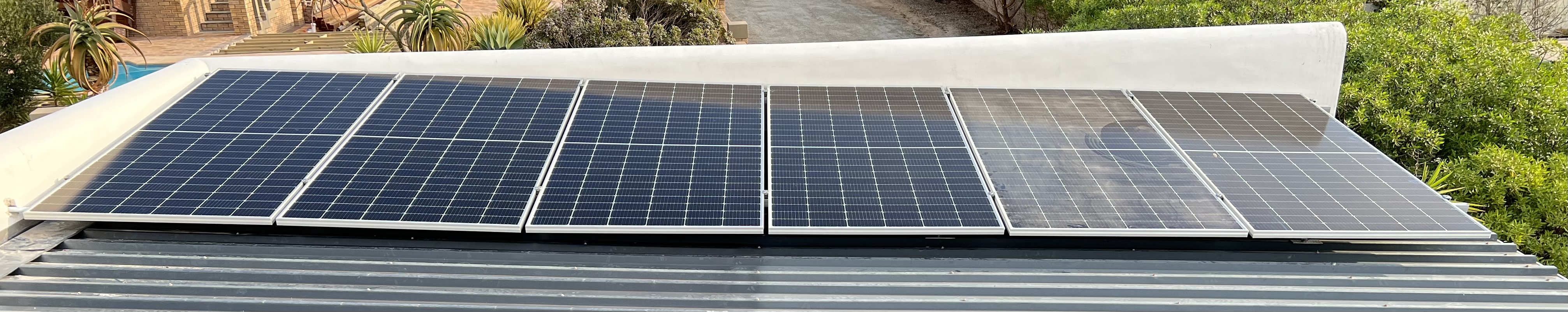

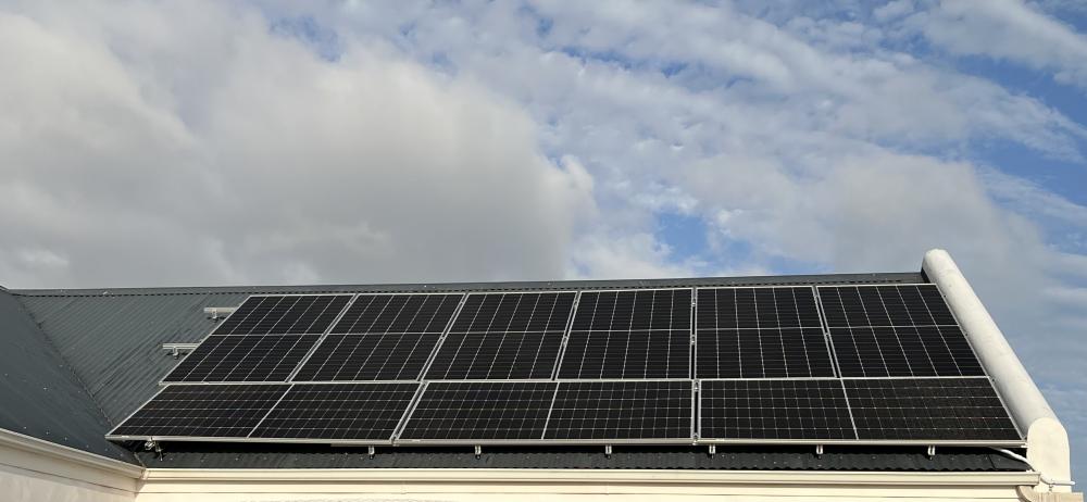

Solar panel alignment not ideal for the sun, but my house was build with wind protection in mind, not sun gathering ……🙈
With this setup 6 x PV’s go “alive” @ 8am and 9 x PV’s go sleep at 6.15pm at the moment. In between all 15 up and running.

Assuming you have the 6 on the one mppt and the 9 on the other. Are you not afraid of damaging the one mppt with 9 x 540 = 4860w in the summer months seeing that one mppt takes 4000w max.
I'm asking as I have the same inverter with 2 strings of 545w x 4 and want to increase it to either 545 w x 8 =4360w or by 545w x 7 = 3815w
56 minutes ago, Future said:
Hi guys
@wannebe
Refer to the 4th posting. Strings are in different directions. String of 9 panels does/could go over the 4kw per MPPT. Luckily all 15 will never produce peak power at the same time. MPPT can in a lot of inverters accept 20% more than spec.
