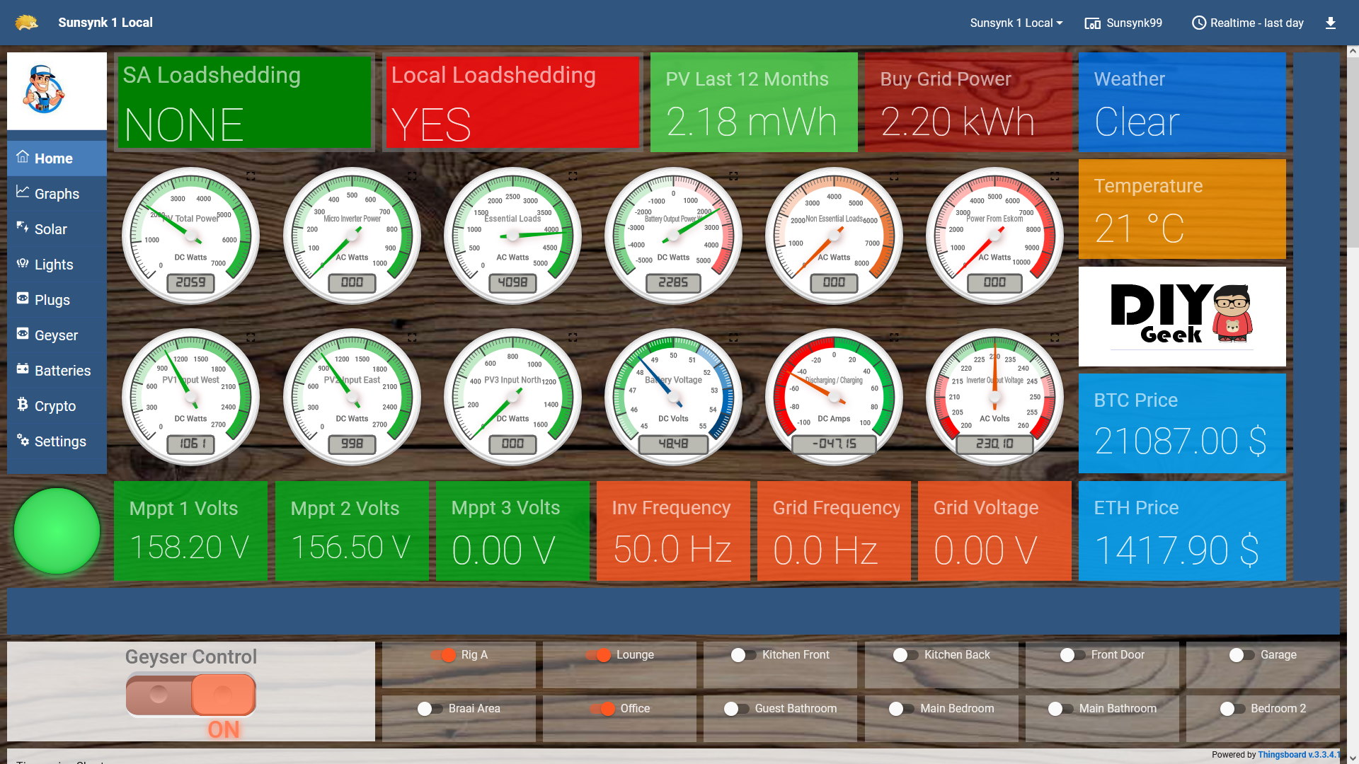

    Hi there @TiaanSmit This is my own custom dashboard with some major input from @Bloubul7 Here is the link: https://powerforum.co.za/topic/12146-sunsynk55-simple-local-data-monitoring-no-cloudint

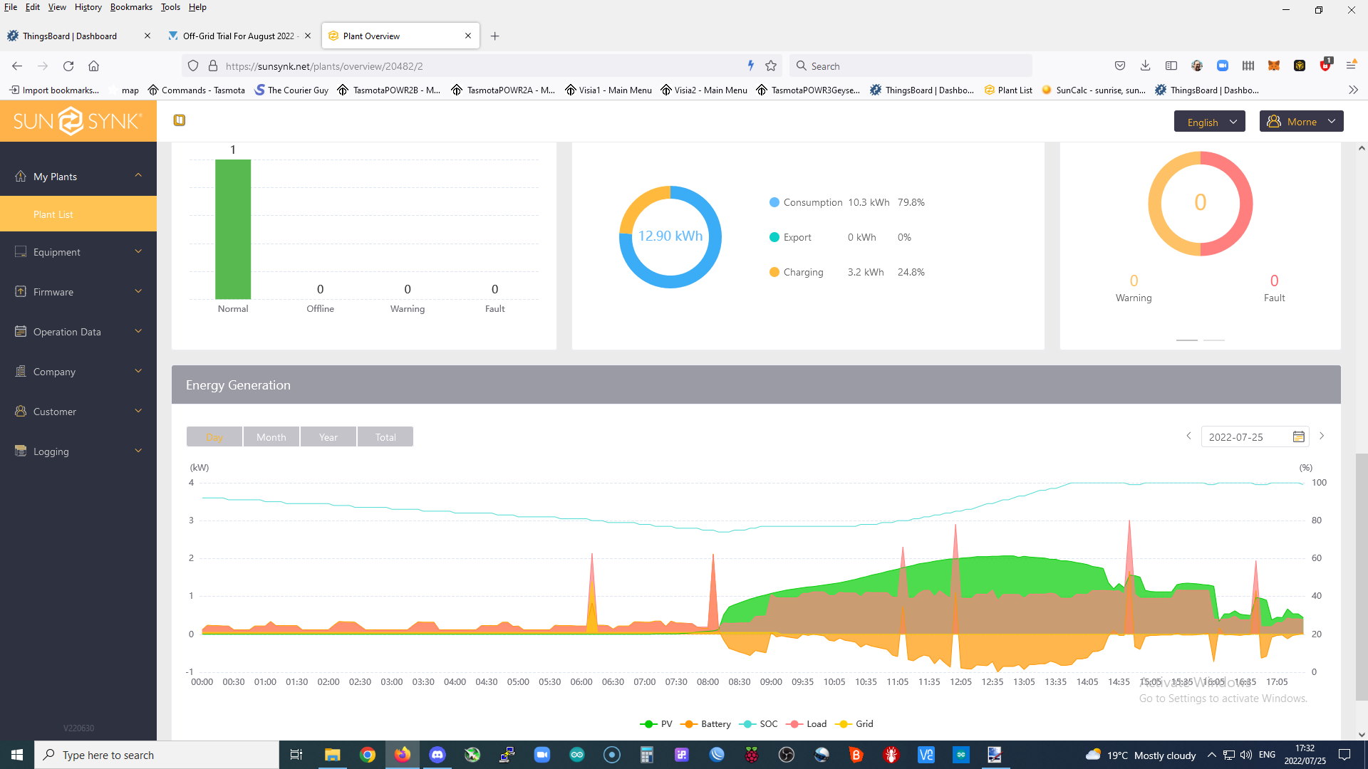

The Sunsynk Portal Stats just don't do it for me anymore :(
Misses a lot of detailed stats. It is more for averaging than anything else.
Supposedly a premium brand but still the same chineesi style el-cheepo energy portal :(
All it's really good for is firmware upgrades.

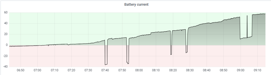

Yay :) Geyser rewired to essential side now and just in time for day 2 trial run 9am till 9pm before going off-grid for the month of August.
Another beautiful sunny clear sky day in Cape Town, so will be a good comparison to yesterday :)
Almost 9am and already pushing 9amps into the batteries.

Amazing the difference in solar input between Joburg and Cape Town at around the same time. Here I am already pumping 50A into the battery at around the same time
Yeah, this side pushing 62A-ish (Centurion). But remember that he will probably be pushing 60A at 16:00 this afternoon when we are at 5A. :P

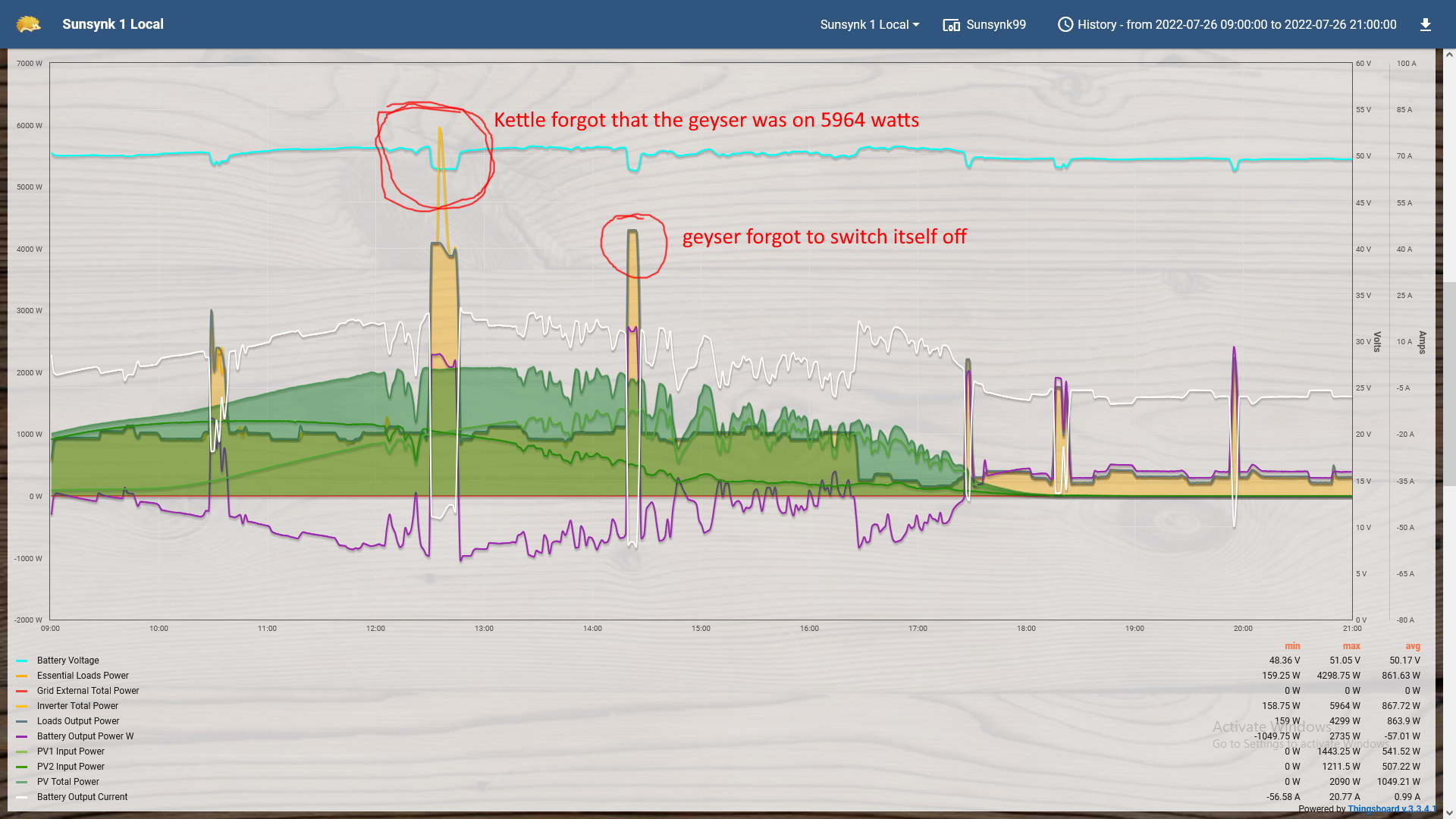

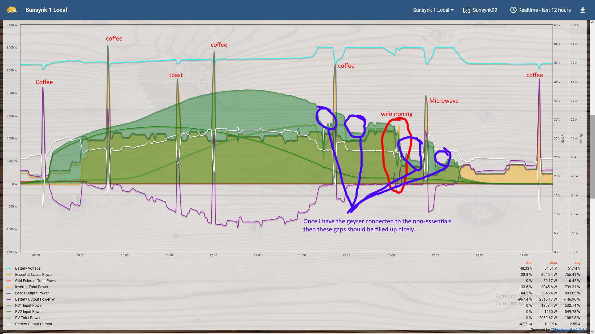

Day 2 of 6 pre-off-grid trial to finetune stuff.
Mixed results today, 1st half of day started off nice and cloud-free, rest of day ended up being cloudy.
Also only realised too late my mqtt controller was off so the geyser and crypto rigs ended up staying on for longer than intended.
off-grid-trial-preparation-day2-cloudy-later-half-of-the-day.thumb.jpg.2c112a54519d19133bfe1d20e7a3a37a.jpg

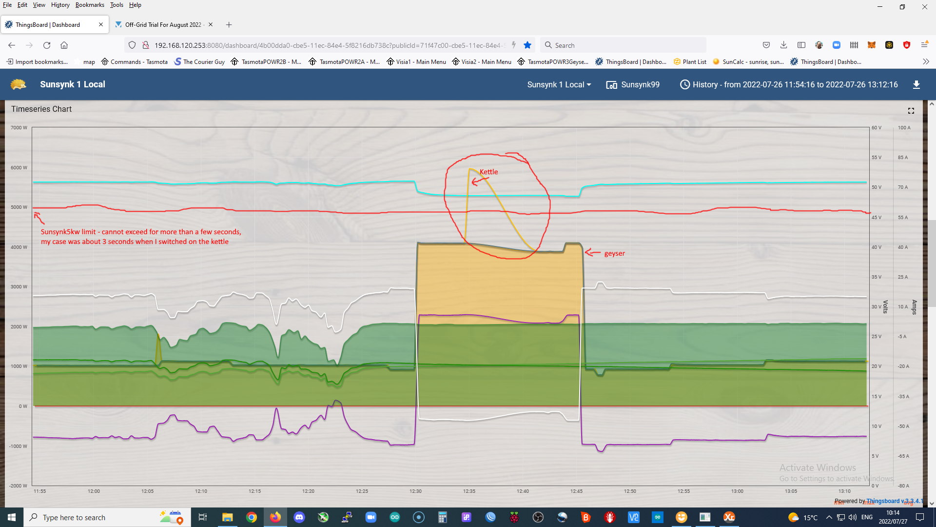

He He, I love it when the Kettle, geyser, fridge and miners are busy together without any communication. 🤣
5964W with no grid AC involved. SunSynk 5kW flexing its muscles.👍
Hopefully a full sunny day in CT tomorrow for test day 3.
On The Inverter Side

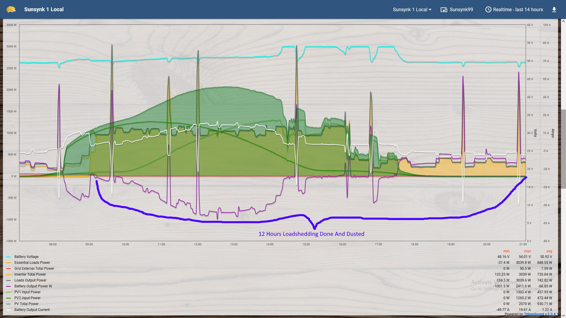

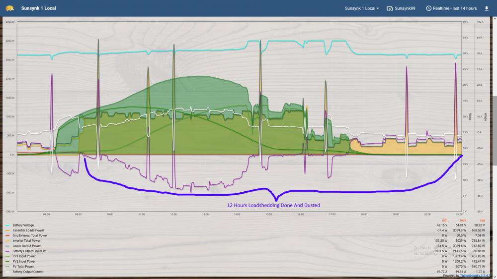

IMHO - My preliminary conclusions so far is that it will NOT BE POSSIBLE to go fully off-grid with a Sunsynk 5kw inverter and still maintain a "semi-normal" way of doing things around the home.
The Sunsynk was not really designed to be an off-grid inverter. Anyone who wants to use their Sunsynk Hybrid to go fully off-grid would actually be wasting what the Sunsynk was designed for.
Fortunately I still have my Growatt spf5000ES that I should actually hook up into my system and reconfigure exactly how I have everything wired up.
Ideally for Off-Grid I should have 2 of the growatts.
I will continue this 6 day trial, but am already considering scrapping the August 2022 off-grid trial, at least until I can add more batteries(see comments below) and get the growatt added into the mix.
On The Battery Side
2x 100ah batteries are just not going to be enough to go fully off-grid.
Mine do make it through the night but only just and also only because I cut my night time baseload down to under 200watts.
One or 2 fully covered dark cloudy days in a row then those batteries would not make it through the night or even day.
On the batteries side you should aim for a minimum of 400ah to even consider a move to going fully off-grid and even then you would need to carefully manage your usage to have reserves for those cloudy days.
This exercise has however shown me I can reduce my reliance on eskom quite substantially and if anything I will be using a sh$@t load less units per month.
off-grid-trial-preparation-day2-prelimanary-conclusions.thumb.jpg.3f04bb6f224877e5f89cc869bd1f5bcd.jpg
