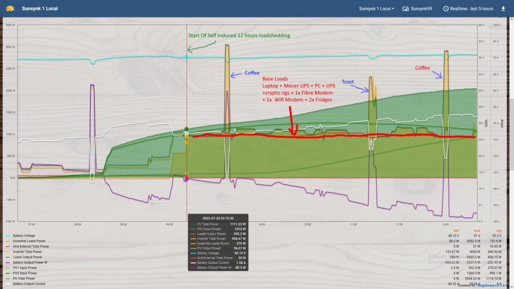

With all the confusing talk of new eskom tariffs with R900pm fixed fee from next year, my wife and I have decided to trial going fully off-grid for the month of august using our modestly sized DIY solar system.
For the next 6 days till the start of August I will be doing some trial test runs just to fine tune timings of everything.
For starters I am running Loadshedding from 9am till 9pm.
My crypto mining rigs will now only run from 9am till 3pm everyday to give the batteries a fighting chance :)

Ok, so only an hour into this exercise and I already have a "minor glitch" 🤣
I need to rewire my geyser as it is not on the transfer switch to move onto my non-essentials side when off-grid.
This was all fine for normal loadshedding, but for off-grid it is no good.
Now 1st need to go buy a breaker and then redo the geyser wiring.
That's why these "trials" are so important :)
On the plus side, I already have 6amps going into the batteries and it's only 10:30

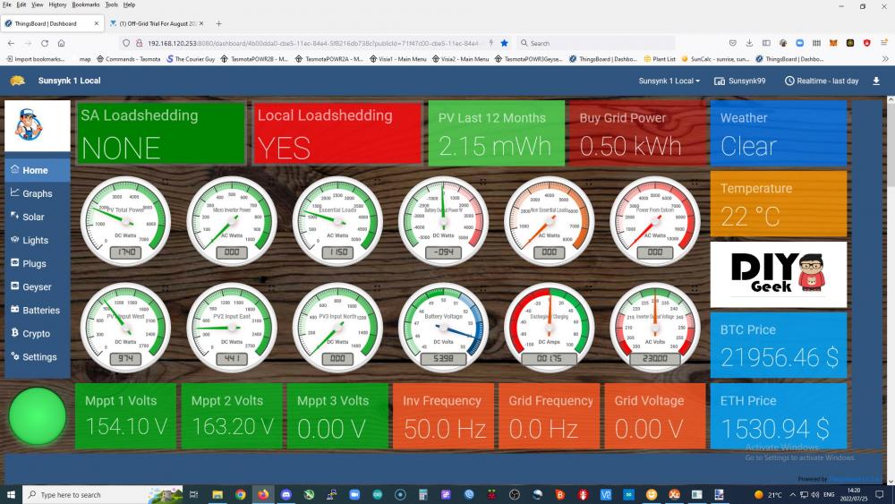

31 minutes ago, WannabeSolarSparky said:
Battery Bank Fully Charged so crypto miner can run at least till 4pm instead of 3pm.
Will see what happens tomorrow when I have the geyser rewired correctly for off-grid use.
offgrid-trial-6-days-fully-charged-battery.thumb.jpg.6a3ab281bf00c17e8b6d6e8330d4d662.jpg
This interface, is it the solar assistant interface that I keep reading about? does it integrate with home assistant?
Hi there @TiaanSmit
This is my own custom dashboard with some major input from @Bloubul7
Here is the link:
https://powerforum.co.za/topic/12146-sunsynk55-simple-local-data-monitoring-no-cloudinternet-needed-setup-guide-step-1-the-software/
