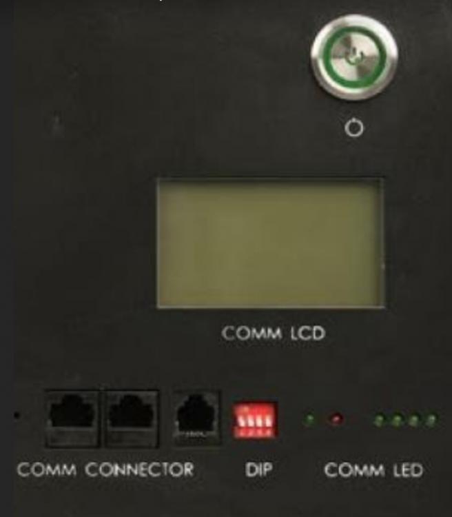

September 16, 20223 yr 10 hours ago, Gavin286 said: https://powerforum-store.co.za/collections/batterys/products/5-5kwh-magneto-super-cap-wall-mount-48v Looks like more info/sales pitch here? : https://www.magnetoenergy.co.za/wall-mount-5-5kwh/
September 16, 20223 yr 11 minutes ago, DJ1 said: Looks like more info/sales pitch here? : https://www.magnetoenergy.co.za/wall-mount-5-5kwh/ Oh I see now, it's a "Super Capacitor", not a "Supercapacitor" lol
September 17, 20223 yr 11 hours ago, jumper said: Oh I see now, it's a "Super Capacitor", not a "Supercapacitor" lol Well, it's not a capacitor at all - there simply is no technology available today to get a capacitor of that capacity in nearly that space. Best case scenario it is Lithium Titanate Oxide (LTO) cells, like the other brand that made a "supercapacitor". The biggest issue is - why lie about it at all?
September 17, 20223 yr 11 minutes ago, P1000 said: The biggest issue is - why lie about it at all? I agree, that's exactly the problem. I also reckon it is probably LTO cells like the Sirius (that was quite a debacle), it weighs 90kg. I was just being sarcastic at the semantics they are playing with 😀
September 17, 20223 yr So COMM is the magic word. Everything is marked as COMM as it has become the buzz word these days.
