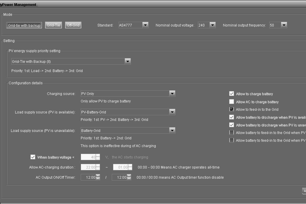

I've included some screen shots of the software settings.

You need to consult the battery supplier to ascertain what the absolute minimum cutoff voltage must be for the lifetime you require from your batteries.
The settings which I query are the following:
ac setup of 240v. Google says NZ is 230v
frequency setup as shown. This may be far too wide as it affects the trips. Some overload controls actually use this (and not amps) to monitor overloads.
battery cutoff voltage 40v - divide this by 4 for a single battery and it may be far too low if it really happens. Members may care to comment on this as I have lithium batteries which charge diffently and easily. You need to measure the voltages with a multimeter the next time the inverter reports it as too low to verify what is really happening.

The 40v you're referring to is not enabled. I believe it is under the grid charging option. I have never changed the value as I only use PV to charge the batteries.

Your settings was to cut out at 42v for the pv side. As per the above settings it means it passed 100% dod.
