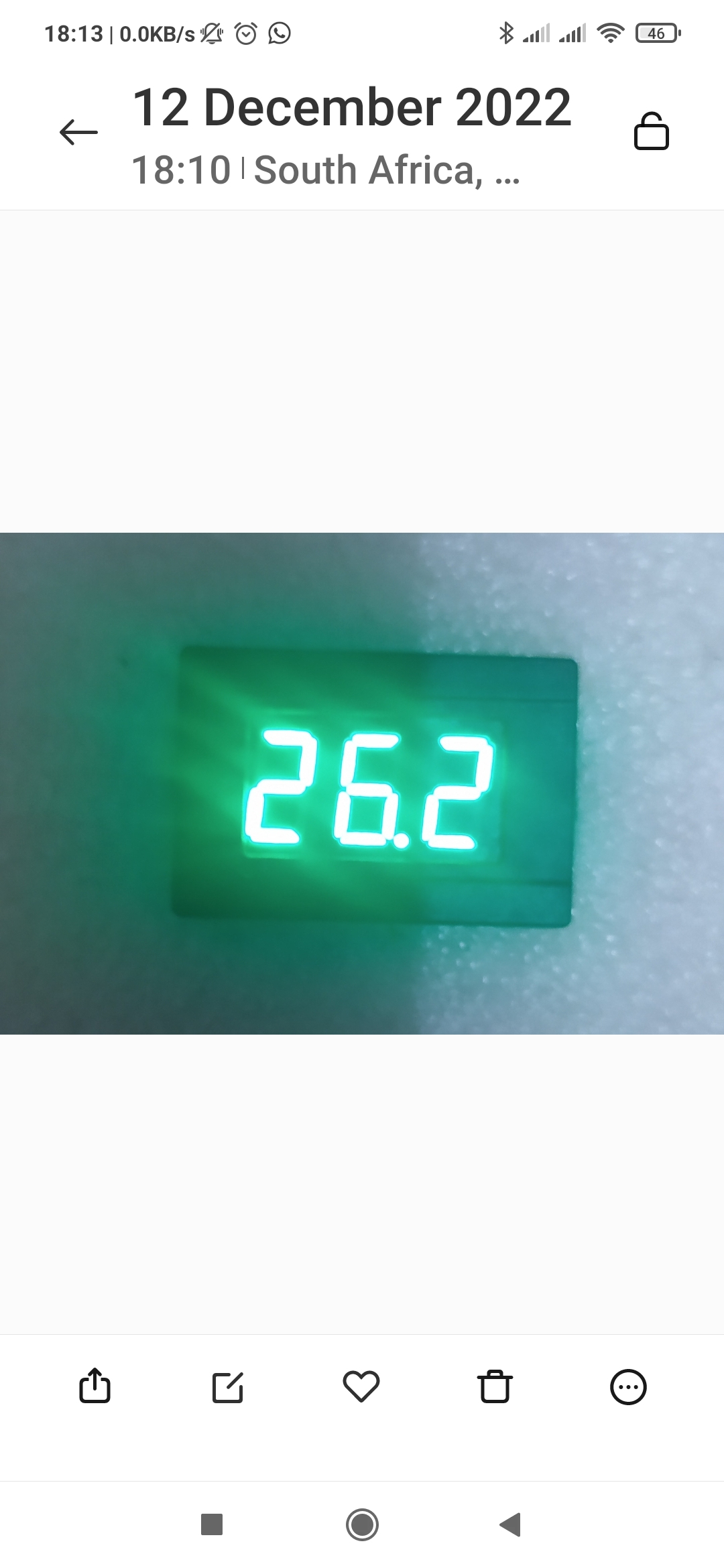

Screenshot_2022-12-12-18-13-35-749_com_miui.gallery.thumb.jpg.34f072b14cc13a56d4cb2d9ba18c6d62.jpg
Update
I noticed something strange. When I have loads connected to the inverter and loadshedding kicks in it shuts down instantly. Almost like it cannot handle that sudden switch. When I remove the loads, turn off the mains and then apply the same loads incrementally, then it handles it with a smile.
I wonder the problem is not related to another component and not the battery.

It depends on the surge ability of the inverter. Something like a fridge, freezer, air con will impose huge surge currents.
Together with this it could also be the ability of the battery to supply the surge current which affects the inverter to start these devices.
