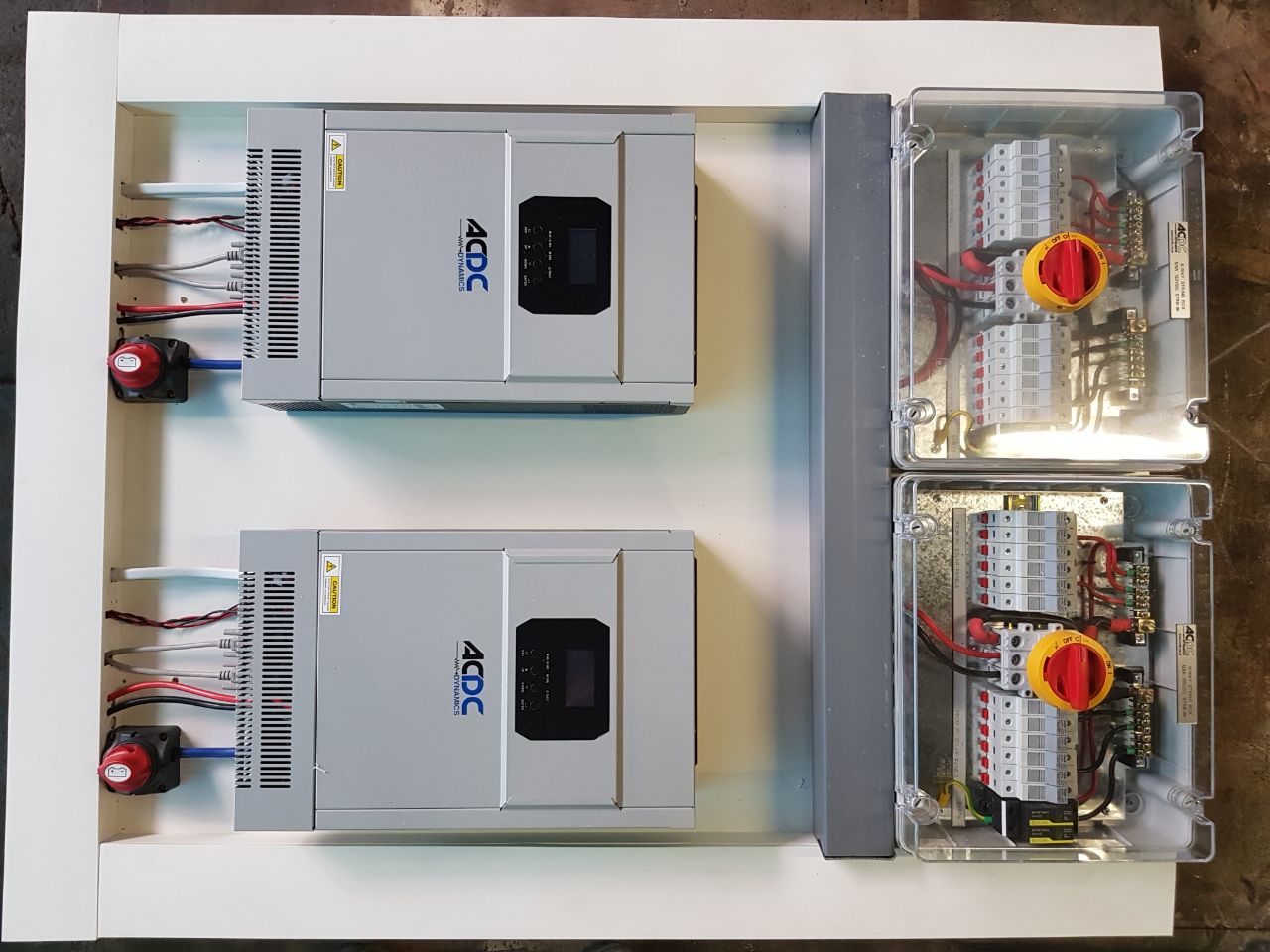

Hi, on getting a parallel setup going..
After everything is connected correctly, ensure the inverters are switched off at their switches.  Now apply PV power to them so they can wake up (they will start charging as well).  Now go one by one and set the parallel setting to PAL  (assuming single phase).  Once done for all inverters, start switching them on one by one.  Wait for the AC out to come online on the first one before switching on the second one etc...
Note, the PAL setting can ONLY be set when the inveter is "awake" and switched off.  That state is only possible with PV power connected in an off grid setup.  If your PV is not yet available, you can get to this state when you apply battery power but you have to get into the menu quick as it will turn off again if there is no PV detected.
Hope that helps.
O, and if you did all this and you still have issues I have seen that it was required to turn them all off (disconnect battery) and power back on again.  I only had that scenario twice in many many installations and can't say why it happened.
