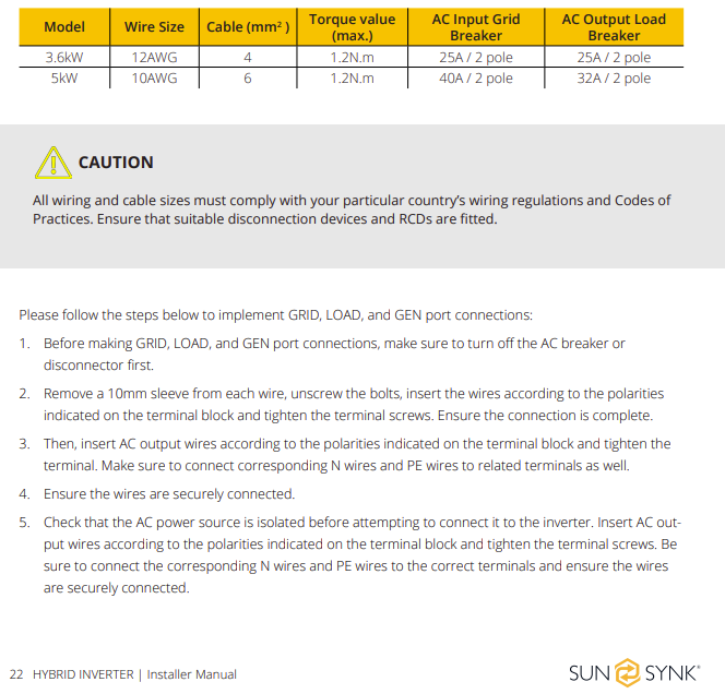

Those are all 3 phase inverters, so it's not quite so ridiculous.
Taken from this manual, page 22: (note the LP3 part)
https://www.deyeinverter.com/deyeinverter/2022/12/07/rand/3659/【B】30240301001058-使用说明书-储能三相-SUN-(5-12)K-SG04LP3-EU-德业英文-封面彩印-封面封底157g-内页70g铜版纸-142.5x210mm-Ver2.2.pdf
Edited by P1000
1 hour ago, P1000 said:
Wow ! so glad about that! i had no idea they made all those sizes in 3 phase . I always just though its the 12KW unit in three phase . Thanks so much .
Edited by Nexuss
AFAIK, that is the only one that is locally available. All except the 5kW is NRS approved, though.
