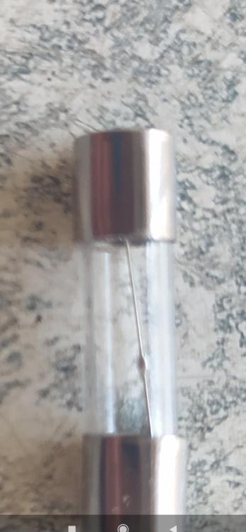

Screenshot_2023-11-05-14-44-36-484_com_miui.gallery.thumb.jpg.e29cdf61dcf2cf9b4b4b41029db6e982.jpg

I have 2x blown fuses. They are the slow blow type which looks like one wire wrapped around another wire.
Like this: image.png.c0c15a8d525eb50e27183e0006f8938a.png
The one blew clean, the other blew with some black marks around the middle.
I was thinking maybe I need to recap the amp as it is an older one. Although based on the feedback from many other forum members, it seems blowing of fuses is an issue with these Luxpower inverters?
I purchased some 6.3A fuses from Chamberlains yesterday, although they only had fast blowing. I generally don't pound on my subwoofer so figured it would be alright for a bit and will at least get it up and running.
So far so good, girlfriend was watching TV when the grid went down yesterday and the fuse did no blow. When grid power was restored the amplifier was in standby mode and the fuse did not blow either.
I will try monitor and see when the fuse blows or what causes it -there is also the possibility of a bad batch of fuses, but I think that is unlikely.
