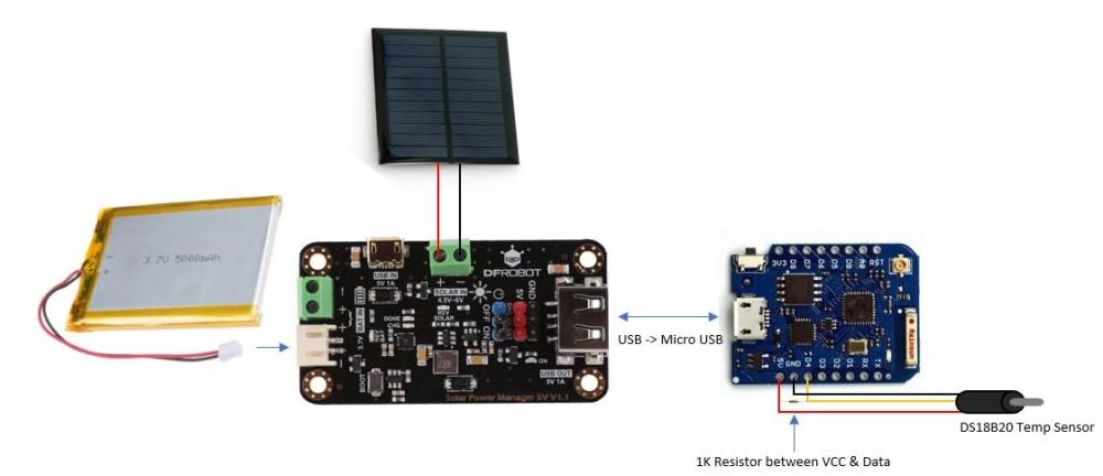

Thought I'd share details of my solar powered floating pool temp sensor that I put together to get pool temp data into Home Assistant.
Hardware required (had to use multiple vendors):
  • 1 x Solar Panel
  • 1 x DF Robot Solar Power Manager
  • 1 x LiPo Battery - for the price, I just went with quite a big one
  • 1 x Wemos D1 or similar - to use the external WiFi antenna, you need to shift a tiny zero Ohm resistor so you may need to find someone who can do this for you if need be.
  • 1 x 1K Resistor - you'll only be able to buy these in bulk, they're cheap and they're handy for LED projects
  • 1 x Submersible temperature sensor
  • A few jumper wires
  • 1 x short USB to micro USB cable: to power the ESP from the solar controller (optional, unless you want to use jumper wires)
  • A few short pieces of wire to solder onto the solar panel to connect it to the solar power manager
  • A few metal BB bullets for ballast
  • A few silica gel things for good measure
  • A Trip to your local hardware store for: Various PVC Pipes/PVC Weld/Epoxy/Silicone from your local hardware store or you can use this 3D print which someone on Reddit put together - I'm thinking of trying this given that the pool chemicals seem to be eating away at the adhesive that I've used to join the parts - the epoxy just peels off!
Schematic:
You'll then need to assemble the actual housing and seal it up really well. Add some metal BB's to get it to float nicely and consider tethering it to the side of the pool with some string (just prevents it from getting bashed around by the Kreepy).
I would also suggest covering the solar panel in some glad wrap or something similar to protect it - the pool chemicals destroyed one of mine after +-6 months.

Nicely done, especially like the pictures of V1 V2 and V3... was the surface water temp giving false readings?  Did you add a brick or something heavy?

Thanks for the feedback - the V1 & V2 versions didn't work- mainly due to buoyancy issues- hence the reason why I added in the longer "down pipe" that sits below the surface - this is where the metal BB's live.
After all the iterations- it didn't take long to build, maybe a few hours but it's quite simple to build once you have a plan regarding the actual device that's going to house everything.
