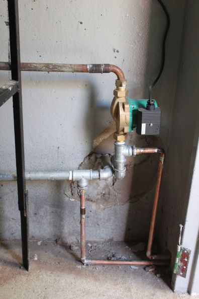

    I have been building a hot water circulation system onto my generators cooling system to circulate the hot cooling water through radiators in the house for winter heating. On cold cloudy days I run th

I have been building a hot water circulation system onto my generators cooling system to circulate the hot cooling water through radiators in the house for winter heating. On cold cloudy days I run the generator for power, and a by product of the power is 150l of hot water in the coolant tank. Apparently for an engine about 1/3 goes to power generation, 1/3 goes to heating coolant and 1/3 goes out of the exhaust as heat.
I am using a fridge thermostat to control the system which drives a geyser circulation pump.
Once the coolant temp reaches 45 degrees, the pump switches on and runs until the water drops below 35 degrees. Yesterday I ran the generator for 3 hours, the coolant reached a maximum temp of 63 degrees and the hot water circulated in the radiators for another 3 hours after the generator was switched off. The generator produces about 2Kw at the inverter, so maybe 3kW at the crank so the engine was producing 9kWh over the period. 150l of water raised by about 40 degrees gives about 7kWh of water heating (1.16wh to heat one liter of water by one degree centigrade). So I have therefore almost doubled the energy efficiency by capturing the waste heat. The next step I suppose would be to try and capture some of the exhaust heat.
New radiators cost at least R7k each, and I couldn't find any second hand ones, so I built them out of copper pipe.
The first is a bit of a sculpture, using the form of a labyrinth, and the second a bit more conventional. I still need to finish the building and then apply some brasso, but you get the idea.
