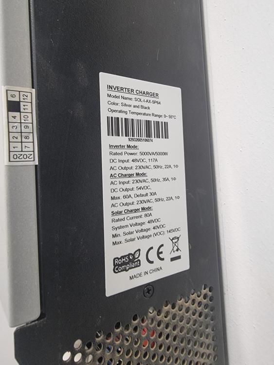

August 13, 20215 yr 8 hours ago, Salazah263 said: Is the 74.40e compatible with this model. I have attached my unit. No, that's a 64 V model. But it's compatible with Patched Firmware version 72.20e, which has all the same features as 74.40e.

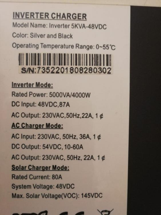

January 28, 20224 yr Hi. What firmware should I update on this inverter. It still runs on 52.30 and where would I be able to find it.
January 29, 20224 yr Have I replied to this before? Yours is a clone; you may not be able to update the firmware at all, and if you can, it might not work with original Voltronic firmware. They might have patched it to suit their copied design. You may be able to run factory firmware version 73.00 or patched firmware version 73.00e. Which flavour (LFP or lead-acid/other) of patched firmware depends on your battery. Both available from the links in this post: PIP-4048MS and PIP-5048MS inverters. Good luck.
April 26, 20224 yr It seams the current firmware version is LC1 72 70C What is the latest firmware version available? Where do I get it? How to I upgrade the firmware? (Instructions for dummies please)
April 27, 20224 yr That's actually patched firmware copied by the clone manufacturer. The latest is 73.00 or 73.00e for patched (LFP or LC flavours). But note that many of the clones that come with 73.00e don't have a bootloader, so they can't be updated at all. One of the patches allows operation without a bootloader (as an unintended side effect, we don't encourage clones at all).
