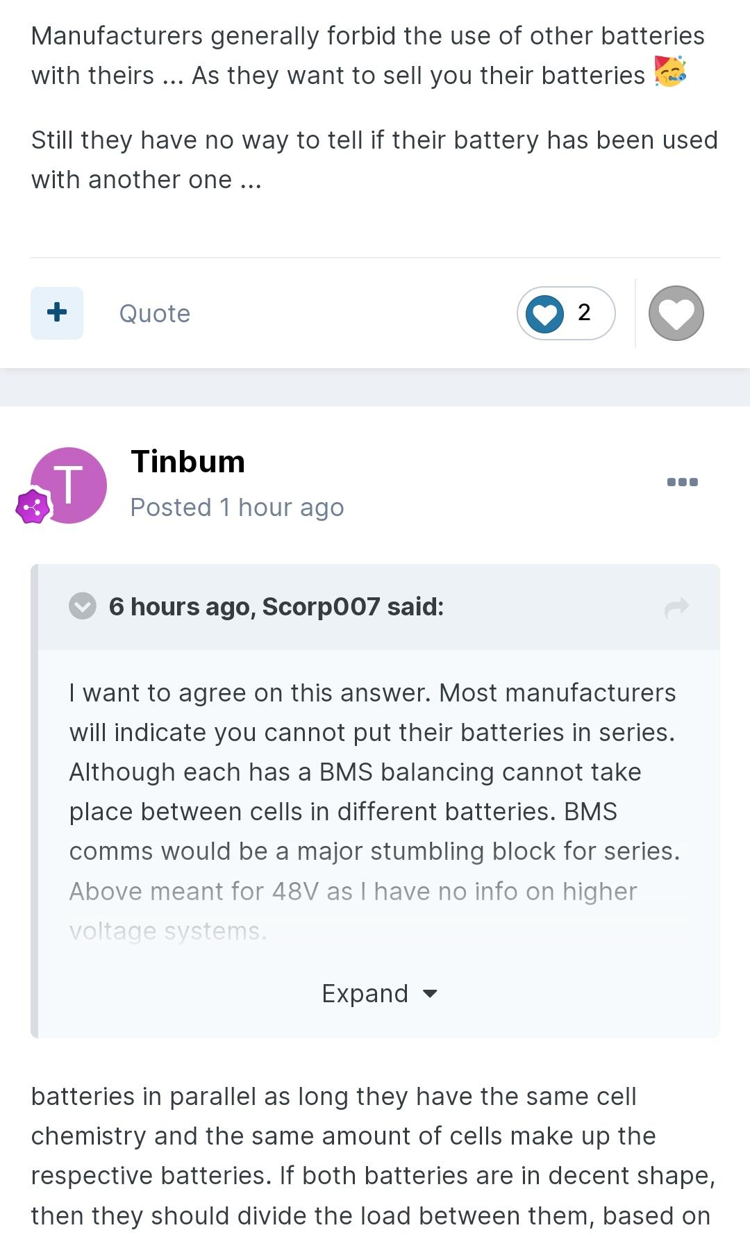

May be someone can help. Since yesterday all text on the forum is very small. Running in Chrome. What can I do?

Ctrl + scrolling wheel in my case zooms in or out, depending on the scroll wheel direction...
No Cntl on a cell? I have changed it under settings but it makes no difference.
Ctrl + to zoom in and Ctrl- to zoom out
Using a cell phone, jy's seker gepik in die bol? Well, for us older fogies, met die brille en die pille, there may be a font size option setting under the control panel / display setting, that's Android, can't remember the rotten Apples settings anymore...

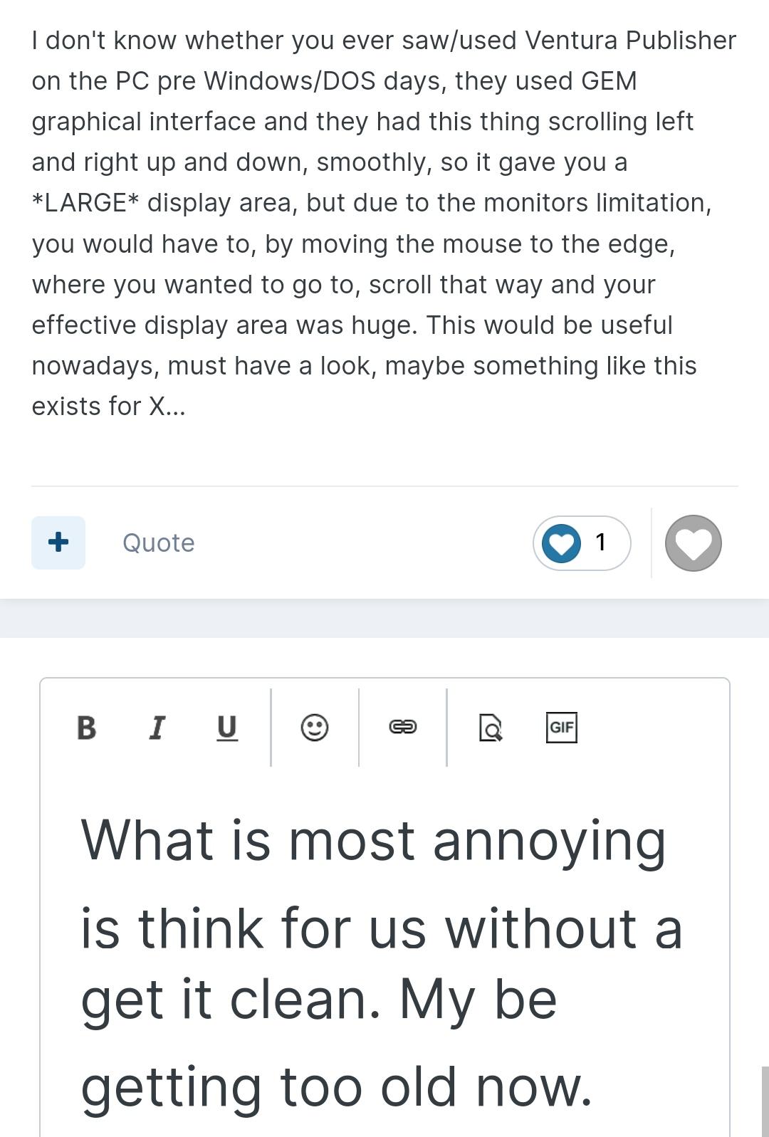

What is most annoying is think for us without a choice. Just bought a Samsung micro card this week. Guess what. Samsung decided to supply it with all the folders for a Android phone. Even every folder for Android. No mention was made about this. I prefer to get it clean. My be getting too old now.
As can be seen. Only the reply will adjust text size as per setting of text in the browser.
The moment the reply is posted... Bang back to find the hidden treasure to read any word. 😉😉

As I indicated I did use it and set to 175% but it only helps while typing the msg. Once posted it is back to small.
I find the problem only on this forum. Using the same browser no change on other forums.
I have not noticed anything different here with the browser on my PC, not sure whether any changes were made, @Energy-Jason have any changes been made to the web server that would cause @Scorp007's font size issues on his Android device?
