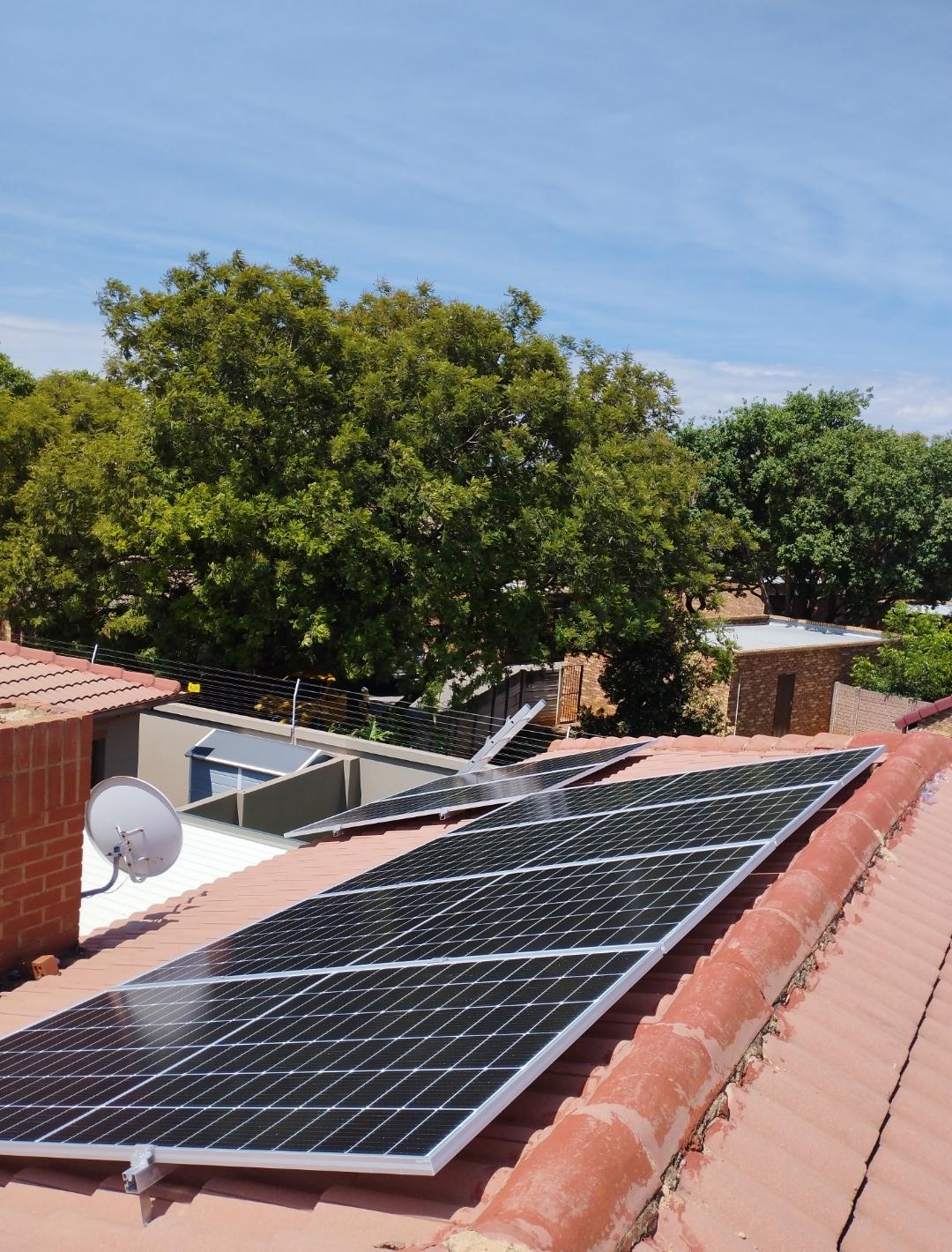

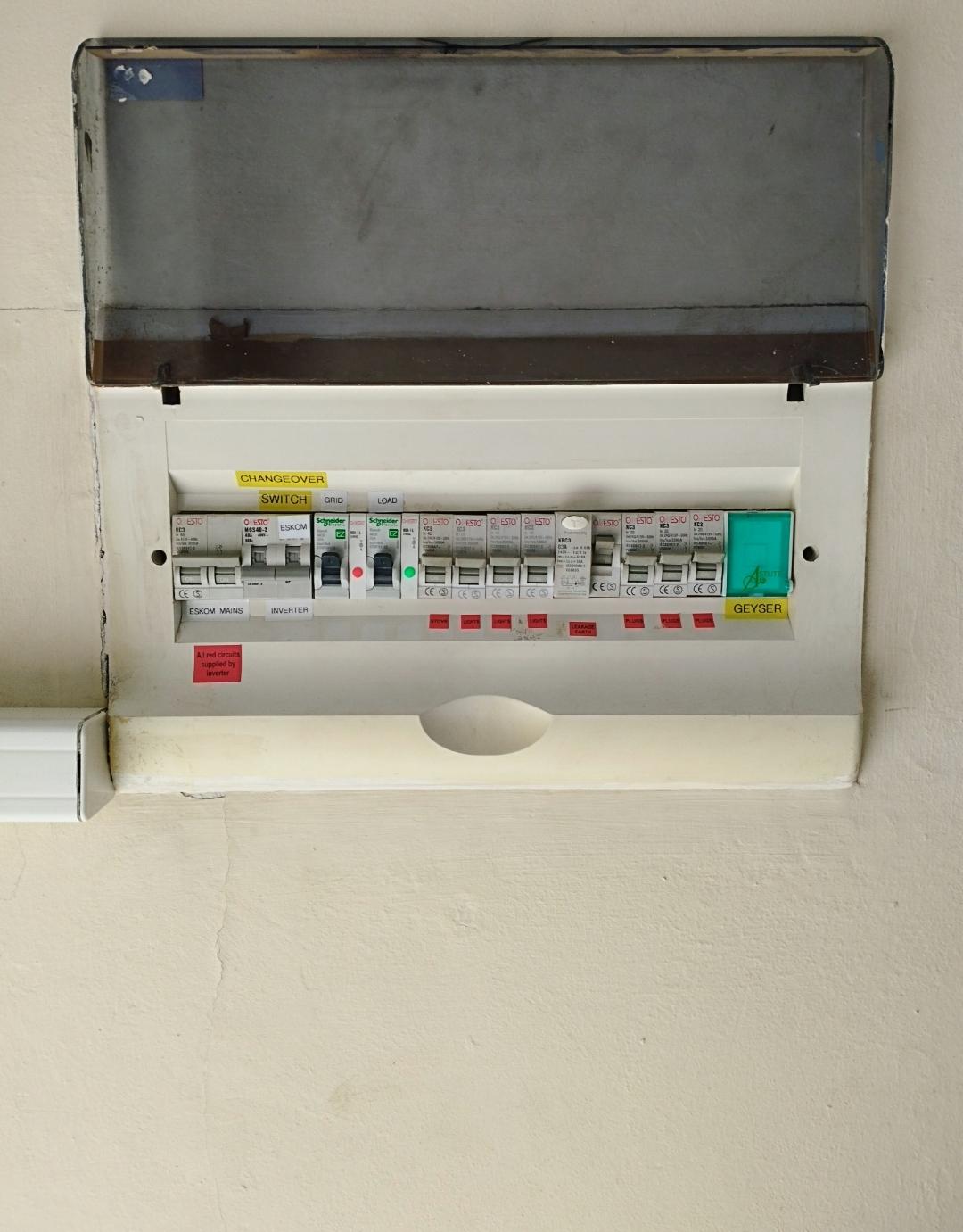

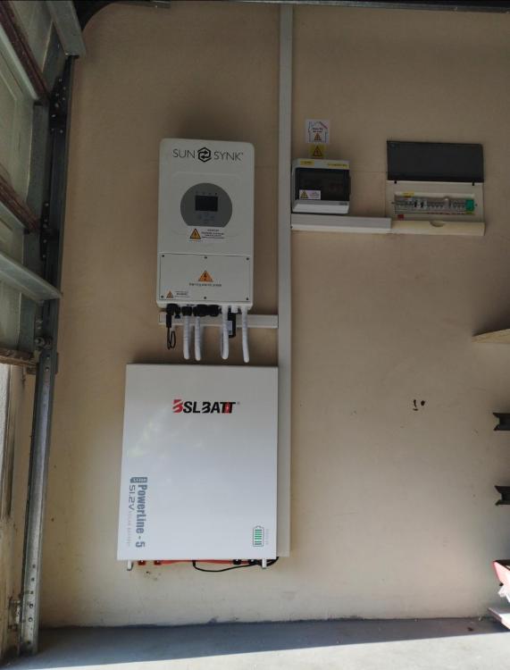

November 22, 20232 yr The most impressive battery in terms of space I've ever worked with...9cm thickness footprint. 1C rated & just a beautiful specimen. Will Install another of these in a living room area next week & will share once done. There was space in the main DB so no New AC DB required. It's all fitted into one.
November 23, 20232 yr This is my installation. It is running like a dream. Haven't used the grid since early last night. Battery was only at 50% this morning before the sun took charge. Geyser just kicked on(Timer) and is using PV and Battery to warm up. Simply lovely. Just want to thank @Steve87 and his team for an amazing experience. It was honestly effortless. 10/10 would recommend!

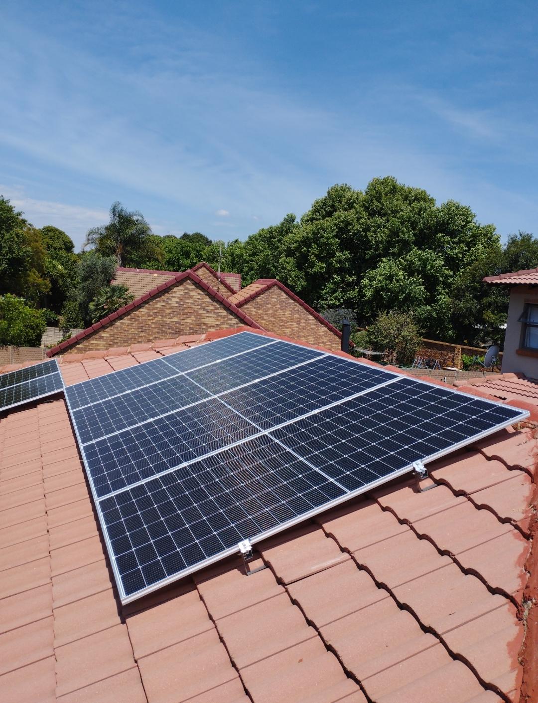

November 23, 20232 yr Hi @Steve87 being 6 Solar Panels are they all going into 1-Mppt or you've split them for this installation?

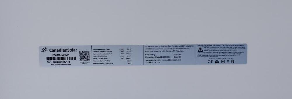

November 23, 20232 yr Author Hi @Moffati only used a Single MPPT. 6 in series works out +- 300V. Which is a good Voc to have. Not sure but need to check because the wake up Voltage is quite high. Not sure if 3 in series can do the trick... Manual will reveal all.

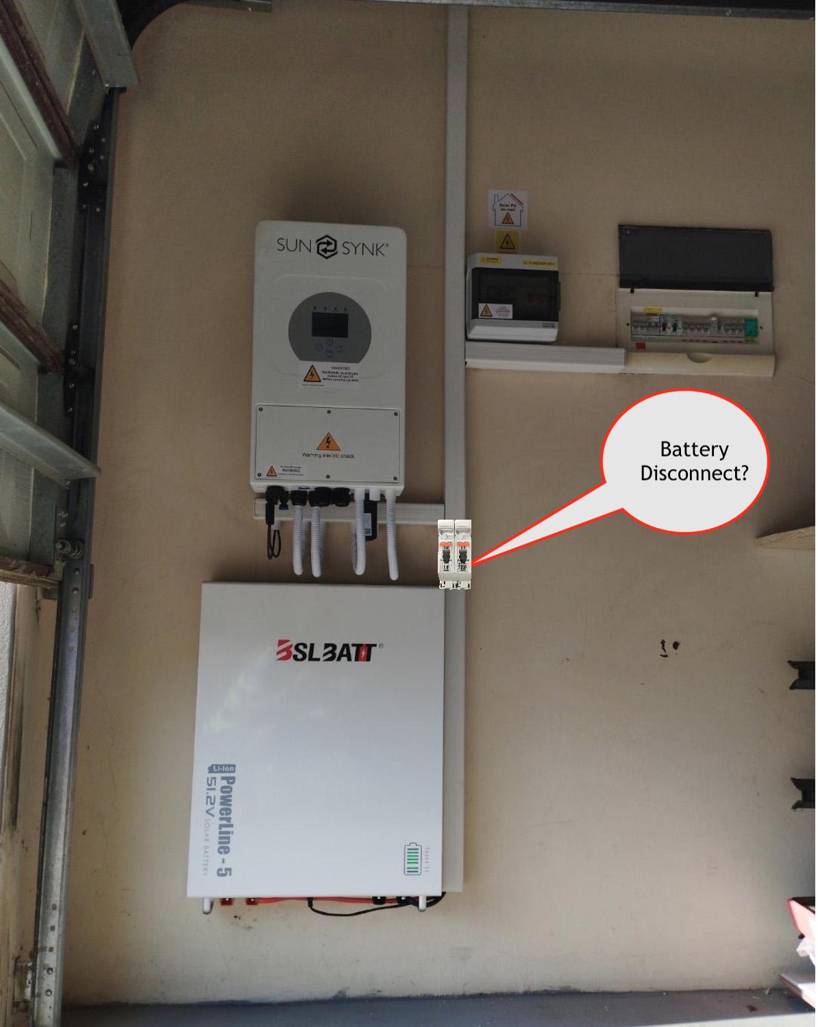

November 23, 20232 yr 35 minutes ago, Steve87 said: Hi @Moffati only used a Single MPPT. 6 in series works out +- 300V. Which is a good Voc to have. Not sure but need to check because the wake up Voltage is quite high. Not sure if 3 in series can do the trick... Manual will reveal all. Startup voltage is 150v according to the 5kW spec sheet, I think it's also the same on the 8kW. Am just wondering longterm (1-2years) if no additional panels are added if this will have any negative effect on the inverter or any balance within the Mppts. I also notice you did not put a battery disconnect on the system along the battery cables (though the battery does have an on/off switch on it), any reason for this? I know some will say it's an unnecessary duplication since you also have breakers up there... See diagram attached. Then my next question is about having PV cables running in the same trunking with AC cables... what's your thought on that? @Pauleywhat loads is your system running. Getting to the morning at 50% is fantastic and I'd be tempted to switch off Eskom for a wee while😃 unless you get a cloudy day with the rainy season. Edited November 23, 20232 yr by Moffat Grammar edit

November 24, 20232 yr Author @Moffatthere is a DC100A MCB in that DC combiner box, there is over current protection, it doesn't have to be a Fuse doing the work as an only option. You have a choice of either. The MCB in my opinion looks much neater for this application instead of a massive fuse & holder box. The DC & AC cables are isolated within that trunking using Spague. No physical way for them to touch. One can use double trunking again but the trunking is made of plastic & so is Sprague so it serves the exact same purpose as isolation & protection & once again I install this way for the sake of a clean neat look. So many DC cables in that trunking & only a single 6mm2 4 core AC Surfix cable to insulate so that the cable that is spragued and kept separate from the DC cables. With only 6 panels that's the problem, if you split to 3 the startup Voltage is not reached. Not using both MPPTs will not have a damaging effect over time at all. The MPPTs work when needed. We only have a choice of 6 panels on this site, unfortunately, we don't have specs for the extra 4 to use the other MPPT. Using both MPPts is not compulsory, you size according to the power requirement. Edited November 24, 20232 yr by Steve87
