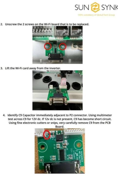

Yes, Sunsynk sent me a new card which I replaced and sent them the old one back. They made it clear that the onus was on me to replace it correctly.
I had the same problem with a data logger. No lights. Apparently a common problem. If you don't measure 12 volts across C9 then there is a short on the board.
I followed the procedure below to get it working again.

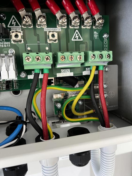

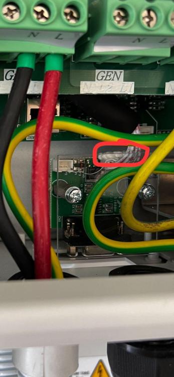

Interesting to see that some of the Sunsynk inverters have a small glass/perspex panel covering the PCB while others don't?
Mine didn’t have that. 5Kw inverter.
