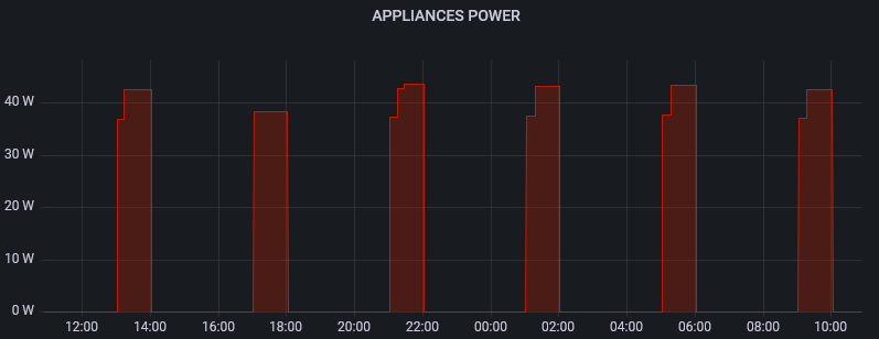

BTW: This is current submerged UV cycle that I've set up, 6hrs total per day. Consumes around 8kWh per month, which is nothing:
